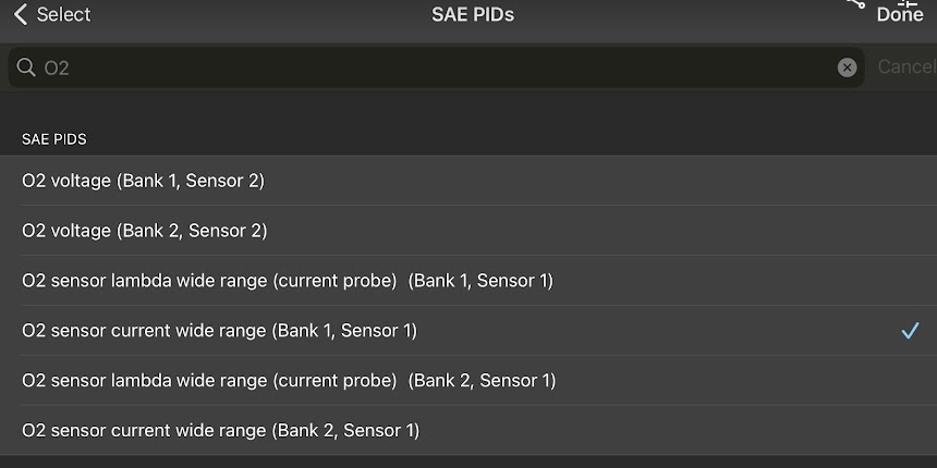

First thing I thought to do was check the bank 2 02 sensors via live data, graph both the upstream and downstream. From what I read the downstream one should be somewhat flattened and not jagged up/down values all over the graph. Unfortunately I'm not able determine which is the PID for the upstream 02 sensor, these are my options:
Available pids

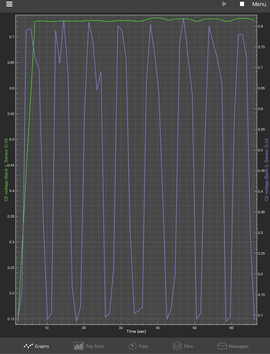

I did graph the voltage of Bank1, Sensor 2 which I believe to be the downstream ones.
Is the above graph enough to indicate that the bank 2 (purple) catalytic converter needs to be replaced?

I was chasing weird fuel trim figures and misfire codes and a lean burn condition on all 3 front cylinders for a few months. Then one day I took out the lower O2 sensor and looked inside the cat with a flexible camera, it looked like the meltdown at Chernobyl! The cat had collapse and was strangling the exhaust so the sensors were seeinf too little free oxygen in the exhaust which told the ECU to run the front bank injectors extremely weak which then caused misfires and power reduction at 3000 rpm. I bought a replacemnet cat from Magnaflow and changed them over a couple of weeks ago and it runs like new now. It took 7 hrs as you have to remove the undertray ( rusted bolts) and then drop the support beam under the radiator and ac condensor so you can and drop everything a few inches so you can wriggle the fan shroud complete with fans out. Then you have room to remove the heat shield, more rusted nuts so had to use an angle grinder, then you can get to the 3 nuts holding the cat to the manifold, also loosen the exhaust where it joins at Y piece under the engine. Refitting is the reverse but fit the short pipe to the bottom of the cat first as you can’t fit it when the cat is in place, don’t ask me gow I know! There were no mountings for the heat shield on the new car so I used stainless locking wire to hold it in place. The cat in your post looks to be correct for the job.
