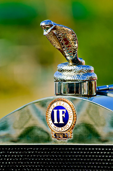

Attached Thumbnails Bonnet leaper on an european X-Type-flat-550x550-075-f.jpg
