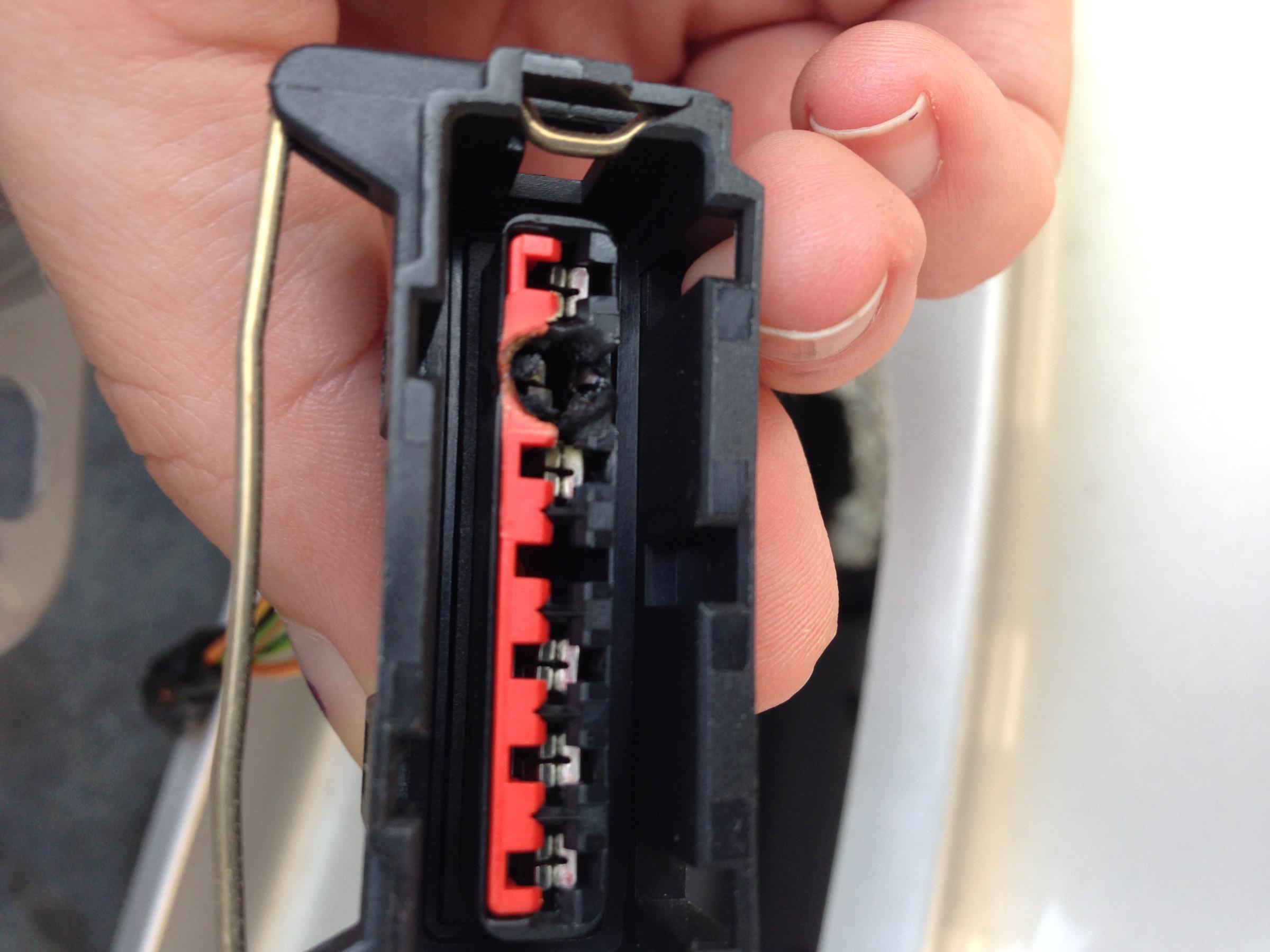

I've made some "progress" or maybe you could call it a setback. I disconnected wiring plug from driver's side tail light and could tell the plug has a burn mark on it and the pin on the tail light was all burned up too. I removed passenger side tail light and disconnected plug and it too had the same burn hole and the same burned pin on the tail light. (SEE PICS)
I pulled the bulbs out of each assembly and they were all good. I think they are the correct bulbs. So, I did some tests. I put back in just the turn signal bulbs. I tried the hazard lights button. Front yellow lights work but nothing in the back. Tried turn signals and nothing at all, not even a tick tock noise. Now for the all important 3rd brake light up on top of the window. If I leave both of the tail lights unplugged, it works just as it should. Headlight switch turned on and pulled out and it still isn't lit but it does light up when you press on the brake pedal. As soon as I plug the tail lights back in and turn the headlight switch to ON and pulled out for fog lights, the 3rd brake light comes on bright and stays on.
A couple other odd things I've noticed today.....when the door chime sound is going on and the hazard light sound is on they seems to cut out and fight each other like a short is happening. When I locked the doors tonight, for the first time ever when I locked the doors with the key the horn sounded. I tried to do it again but it would not honk again. And sometimes the door open lights on chime sound is on all the time even after all the lights are turned off. Other times it chimes with all lights off until door is closed even if key is out of ignition. Bad headlight switch? Both of the burn marks on the tail light plugs are from the black wire. See pics and hopefully someone can guide me from here? Thank you in advance!
Attached Thumbnails Bought 2002 X-Type - tons of electrical problems, help please!!-img_1429%5B2%5D.jpg   Bought 2002 X-Type - tons of electrical problems, help please!!-img_1430%5B1%5D.jpg

Ted, based on what I can tell based on your pics, the pin that is burned is the ground pin. So, yes, with that like it is, you are going to have major issues with the lights and them doing really funny things. In short, what you are having is power applied to where it should, then then it is getting to the ground line inside the tail light assembly and then finding a different way back to ground. Keep in mind that some of the lights are grounded when they are off to help shunt any stray voltage induced away from key components. In this case, it is resulting in a ground path and causing the lights to act funny. In the case of your stop lights, because they are a high wattage bulb (relatively speaking here), they have a very low resistance to them. Now, when you compare it to the running lights, what is happening is the stop lights are dropping very little voltage (due to the low resistance) and the running lights are dropping most of the voltage (due to their high resistance) and this is making it appear that your running lights are on and your stop lights never work.
As for the fix, you can start cussing my name now. In short, you are going to need to get 2 new plates for the rear of the tail lights (see if you can find some cheap cracked tail lights on e-bay as you only need the plastic piece that holds the bulbs) and then you are going to need to find a scrap plug to steal the pins out of and then hopefully you can fit the new pins in there solid enough to make good electrical connection.
Lets see what you have at that point and we can sort the remaining problems out from there.

innzane, as for the cause, it can be a few things. I have seen a few cars suffer from this very problem, so, I would be betting that it is more of a manufacturing issue than anything else. But, this can also be caused by simply wanting to install brighter bulbs which really means that you are pulling more power (aka, current) through the single ground wire. This can lead to overheating which then only makes the problem worse as the heat causes the resistance to go up and generate more heat. I can tell by the pictures that the one pin got really warm and was what was leading to the issues (maybe not all, but a majority).
As for the problem reoccurring, it can always occur again. The question becomes what caused it initially. You have to fix that first and then the rest will fix itself. If it is a manufacturing issue, something as simple as putting a new connector in there will fix the problem most likely. I need to think about what sort of power could be potentially running through the ground wire. I am thinking it will be in the neighborhood of about 8 amps worst case (35W(3A)) reverse lights, Stop lights (35W(3A)), running lights (20W(1.5A)), plus a little bit for error. This may be simply too much to pass through the single connector. It may be also be something as silly as when they manufactured the plug, the machine that held the connector just happen to slide into the #6 spot and mushroomed out the connector which resulted in a less than idea connection which then allowed for a high resistance connection.
There are lots of things running through my head right now about what could be causing this problem. This is one of those times where putting my hands on the problem would help me out greatly as I can play with things a little bit and also see the fine details that can point to ultimate cause.

ted, if it was me, I would be getting my hands on a new set of plugs and then pulling the wires out of the old plug and sliding them into the plastic of the new plug. If you can avoid doing a splice job, by all means do so. You will be better off in the long run. What you may end up doing is simply cutting the metal tab off of the end of the ground wire and then soldering the ground wire to the new metal tab. This will get your connection inside the plug and be better in the long run. Just make sure to get the correct wire in the correct hole.
To pull the wires out, get your hands on a set of jeweler's screw drivers. Remove the red tab from the plug. Look inside the plug and you should see what appears to be a little sliver of metal sticking out of the metal tab. You want to slide the screw driver in next to the metal tab and depress that sliver. With the sliver depressed, you should be able to pull the wire out of the connector. Transfer it over to the new plug. Do not forget to gently pry the sliver back up so it will lock back in once in the new connector.
As for finding the cause, I highly recommend doing this or else like you mentioned, you can experience this again. The question is what you are going to find if you find anything at all. It could have been something as simple as the metal tab not made up properly which due to the nature of the problem has destroyed all evidence. Or, it could be something as obvious as someone installing high power bulbs into the tail lights with the intention of making it more obvious that their car is there. A little bit of detective work will be needed to see what you can find.
As for the remaining problems, it can be that your tail light plugs are shorted internally and that is causing your problems. Fix the tail lights and then see what you have. It is possible that you have multiple problems.
When it comes to extra wiring, this is a cost saving thing for Jaguar believe it or not. For the back half of the car, they pretty much use a universal wiring harness that has the plugs for every possible option. That way, they only have to play with 1 wiring harness vice having to choose from say 4 different harnesses. Hence why you have all this extra wiring that can potentially be an issue.

Ted, if you want to splice the wires together, that may be an option for you. I would recommend finding yourself some "Raychem WCSF" heat shrink. When you see this stuff, you will understand why I recommend it. I use it at work to survive a nuclear reactor meltdown (literally). The benefit of this stuff is that it has a special glue on the inside that once you seal it down and get that glue warm, it will seal to the insulation of the wiring and make it like the wiring was never cut. You would probably need something like:
Raychem 4 Feet of 366 inch Aprox 3 8 Diameter Heat Shrink Tubing Adhesive Lined | eBay
What you will do is to cut the wiring and strip back about 1/2" on each end of the wiring. Match up the wire colors and lay the exposed copper side by side (from the car harness and the new plug) and then solder the wires together. What you will want to do is before you solder the wires together, slide about a 3" piece of the raychem tubing over the wire and slide it out of the way so it doesn't get exposed to heat. Then after the wires are soldered together, you can slide the tubing up and shrink it down with the solder joint in the middle of the tubing. You want to make sure that once it is shrunk down, there is a small orange "ring" that forms at the end. This will tell you that the glue has gotten warm and has sealed.
What you will probably want is some stuff called "WCSF-070". The 070 is the size that the tubing will shrink to (ie, 0.070"). That is about the size of the factory wiring.
