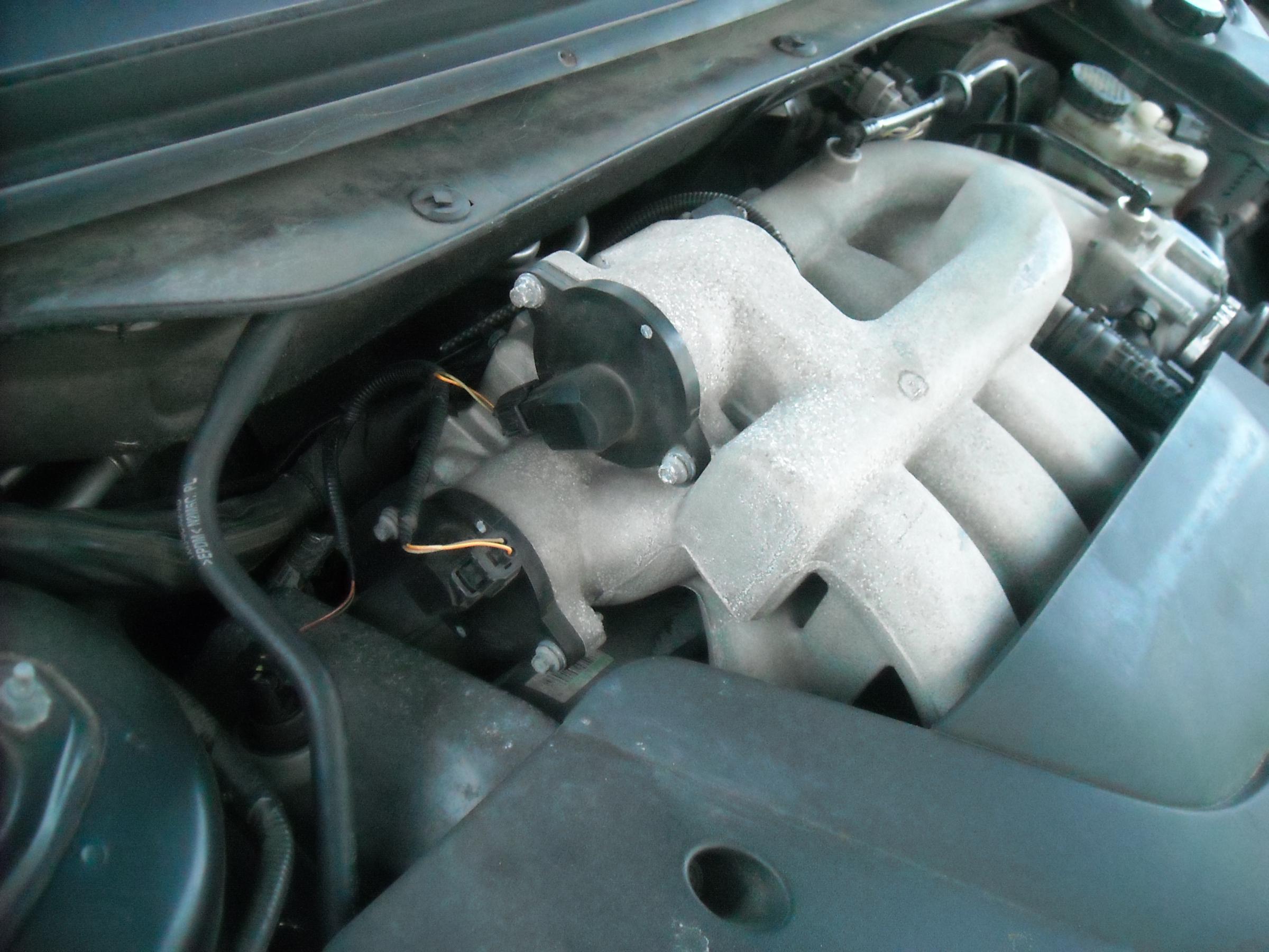

I would have the codes cleared( autozone for free) or do it yourself if you got a scan tool. Then I would run it and see what codes come back. If any PO174s or any lean codes come up you still have a vacuum leak. Have you replaced the two tuning port O Rings(facing engine,two black round plastic units on the plentum left side with connections on them), they both CAN be removed WITHOUT dismantling any other part, the lower one has to be turned just right but they come out. another thing you can do is with the engine idling spray some carb clean around any vacuum connection or hose and see if the RPM changes keeping it away from the exhaust manifold.You can use WD40 also but it's messier but has a higher flash point.

THESE are the two tuning ports
Attached Thumbnails Brake Booster Vacuum check valve-040.jpg   Brake Booster Vacuum check valve-039.jpg   Brake Booster Vacuum check valve-038.jpg
