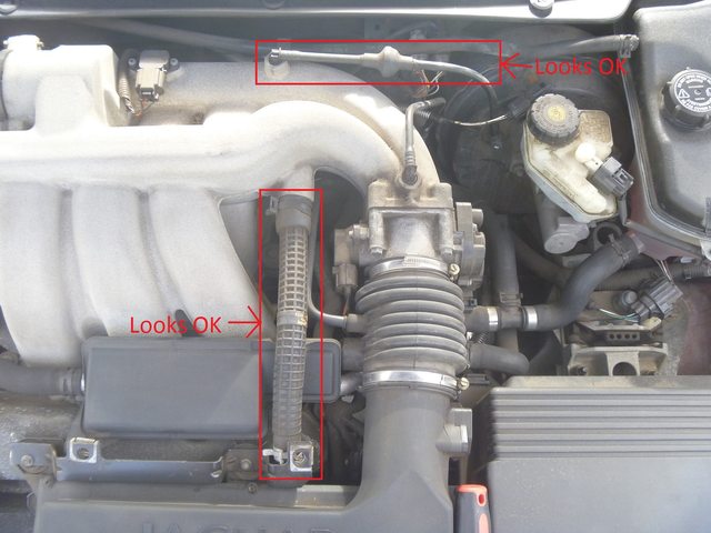

Hey sorry guys, thought it was going to be a free weekend but the gf had a friend visiting so we had to play tour guide. Free now though so getting to work. Thanks everyone, especially Thermo! So I checked out both of those lines but didn't notice anything wrong with either. I circled the ones I looked at in the picture below to make sure I got the right ones. I tried braking with the car on and off and what i found was that with it off I couldn't even drepress the pedal more than an inch or so, and with it on I could depress it all the way to the stop, but it took a lot of force and moved really slow because of the resistance. Not sure if that helps.

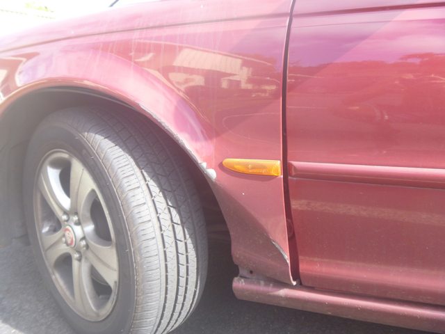

Also, I'm putting a picture of my fender below, think your guy could repair that Thermo? I know it's a pretty bad one...

I'd try pulling the line out of the vacuum canister and with the car running put your finger over the end of the line and see if you have a good strong vacuum coming off the engine. If so, it's time for a new vacuum canister, if not you've got a vacuum leak somewhere or the check valve is shot.

That fender is certainly fixable but you may want to remove it from the car to get the dent out.

ekuest, oh yes, he can get your fixed up no problem. That isn't that bad. Worst case, he replaces the fender. NOt that big of a deal.

As for the fender, a body shop near me said they wouldn't touch it and recommended replacing the whole fender. That was ~$1000 and the whole car cost me that much so I said no thanks. If I could get it banged reasonably straight for under $300 I would consider it. Any more than that and it's just not worth it to me since it's purely cosmetic.

It's where the hard plastic line from the engine/check valve plugs into the big black cylinder behind the brake fluid reservoir. In the first picture you posted it's up in the top right corner.
ekuest, you are looking at the correct lines. As for what is causing your problem, I am somewhat stumped. It would almost appear to me that you have an issue with the ABS module (behind the passenger headlight). It isn't porting the brake fluid properly to the calipers. That is leading to the high resistance that you are seeing. Granted, I have a silly question, do you have a Check Engine light on? Is your speedo acting properly? I only ask this as it kinda sounds like the car is seeing a wheel (or two) not spinning and it is trying to engage the ABS system and not apply lots of pressure to the brakes.
ltmax, how do I unplug that line? I don't see any clips or anything and I am afraid to just start yanking on it. If there was no suction on that line then wouldn't there be not enough vacuum in the header and the engine wouldn't work or would at least run rough?

To pull the line off you just pull on it, it's just pressed into a grommet and into the power brake booster. Just take your time and be gentle enough not to break the plastic line. Once the end is out you can rotate it around to get at it and check for a good vacuum signal.
I think you're going to find that you've either got a bad vacuum leak (something up with the hose/check valve, or big vacuum leak on the engine like intake manifold o-rings or broken hose) or more likely you have a good strong vacuum signal and that will confirm that you need to replace the power brake booster. If you do, I'd recommend putting a new master cylinder in at the same time so you don't have any more trouble down the line as they are pretty cheap and it's got to come off to get the booster out anyway.
One more real easy thing that may be causing your problem, one time years ago I had a guy bring me his car after he did a brake job and you had to step on the brake pedal with all your might to get it to stop, it turns out he mistakenly put the pads in backwards and the metal on the brake shoes was pressing on the rotors and the pad material was on the caliper side. Might be worth giving your pads a quick look over and just make sure that's not the case.

Haha wow! I hope I'm not that braindead, but I will be sure to check when I get home tonight. Seems like you would get some pretty bad grinding or squealing noises with metal on metal braking like that.
