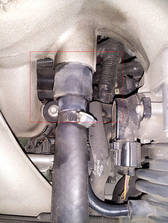

Upon inspection I found that the nipple that where the breather hose attaches to the manifold is broken right a the place where the edge of the hose where plastic piece (nipple) widens to attach to the manifold and when I turn the car one, the hose completely flattens.

The break is right at the end of the hose where it attaches to the plastic nipple. The part where the hose attaches actualyl goes into the body of the niple about 3/8".
Hasa nyone else run into this situation and is there a solution that does not involve buying the entire manifold?

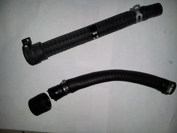

You are correct. I stopped by the dealer to see what he had; after I got there, the parts man did not have an answer. Finally, I took the part to the car and figured out that the new part includes the connector and the old one needs to be removed. The new hose looks alot sturdier than the old one. Here is a picture of both hose where you can see the difference between the old 2-piece and the new 1-piece:
I had codes reset and so far they have not come back.
What I find interesting is that I e-mailed the picture to three other Jaguar Dealer Parts Departments and none of them knew about this. Pretty scary.
