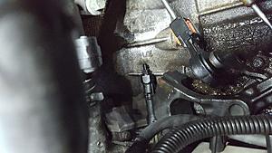

I had an issue for a short period whereby the clutch would go down and i would have to pop it back up with my foot but no issues with gear changes....
The on pulling up at home a short time late...approximately a week with the pedal sticking intermittently the clutch went down the car stuck in gear clutch on floor. long story short i managed to get it out of gear and hit google for a diagnosis..
I have changed the spring at the top of the pedal, clearly did not make a difference and then the next step was to change the master cylinder (pig of a job) all done with the trusty Haynes manual, however when coming to bleed the system i only had this bleed valve via a black plastic tee on top of the gearbox and not the one under a rubber grommet as described in the manual. this was bled through with a pressure kit successfully but no pressure in the clutch at all goes down and can pull up with a hand..
does this mean its a slave cylinder gearbox out job or am I bleeding the wrong thing

It is always a good idea to change out both the master and slave together as when one fails, the other is typically close behind.
Perhaps the slave is the one that failed, thus causing the pedal to remain on the floorboard.

Thanks for the swift responce, I have a 2006 2.2D Sport 6 speed
Think it must be the slave cylinder but will go for a clutch change at the same time...... the bleed nipp;e threw me as i spent ages looking for a rubber flap to pull out

Mr Clutch in Tunbridge Wells is doing it on Monday, new CSC and clutch kit with a gearbox oil change whilst they have it out it for £500 inc VAT
sounds fair to me, I will feedback after I pick the car up as its nice to be nice and spread a good job well done
