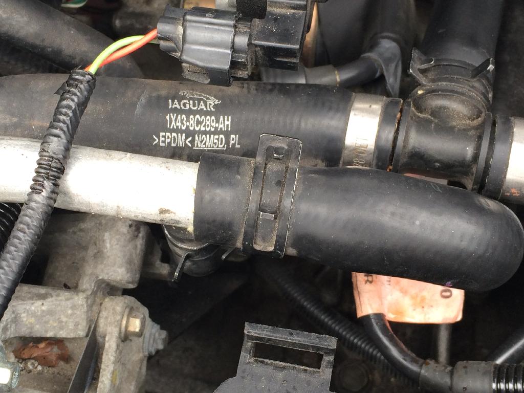

Hello guys,
I was doing some maintenance on the car Saturday morning and noticed that the larger hose that runs from the reservoir to the engine (with a plastic fixture in the middle), is leaking. I am trying to order the part, but nothing comes up with the part number. The part number stamped on the lower portion of the hose is 1x43-8c289-ah, and I can not find what number it was replaced with.
Does anyone have any ideas?

Here is the hose in question :
Attached Thumbnails Coolant reservoir hose leak.-9ac0897c-e2ec-4dd9-a6d1-f8d518c66ace_zpsnaujfmip.jpg

Just using 8C289 brings up various hoses for different makes of vehicle

Default Coolant return hose c2s23485
I had same problem!
COOLANT RETURN HOSE C2S23485
