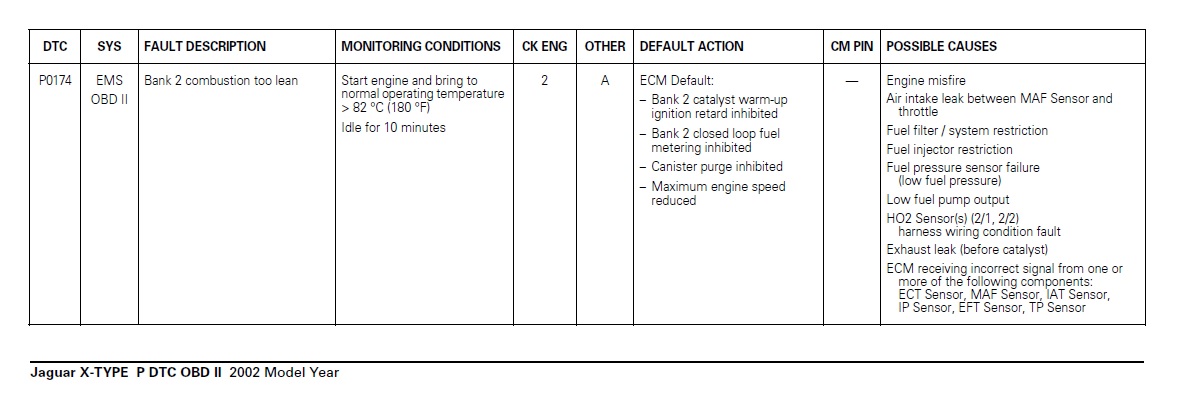

Old Mar 24, 2013 | 12:00 PM
Originally Posted by steelfan2112
the only code I got was p0174 I cleaned the mass air flow sensor and reset it and it was fine for a week or so then it came back on
The CEL will have come back after two consecutive 'trips' because the fault wasn't cleared.
There's more than just a dirty MAF can cause P0174. Here's the list of possible causes:
Air intake leaks is a regular but also plenty more there to check.
