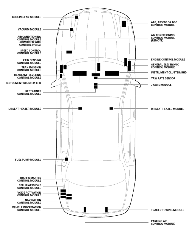

Do u know where is the gem module located in the car

Default Module Locations
Here is some info:
