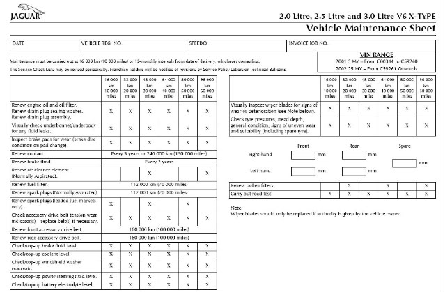

Werent the plugs changed as per the service schedule at 70k miles?

no the plugs were not changed. I thought the plugs were supposed to be changed around 100,000 miles? I will have to take a look at my manual. Could bad plugs be the problem?

It could be anything, plugs,coils, fuel system....
Plugs are changed at 70k according to my service sheet....

thanks for pointing that out. I guess I will start with the plugs. Should I stick with the dealer plugs?
