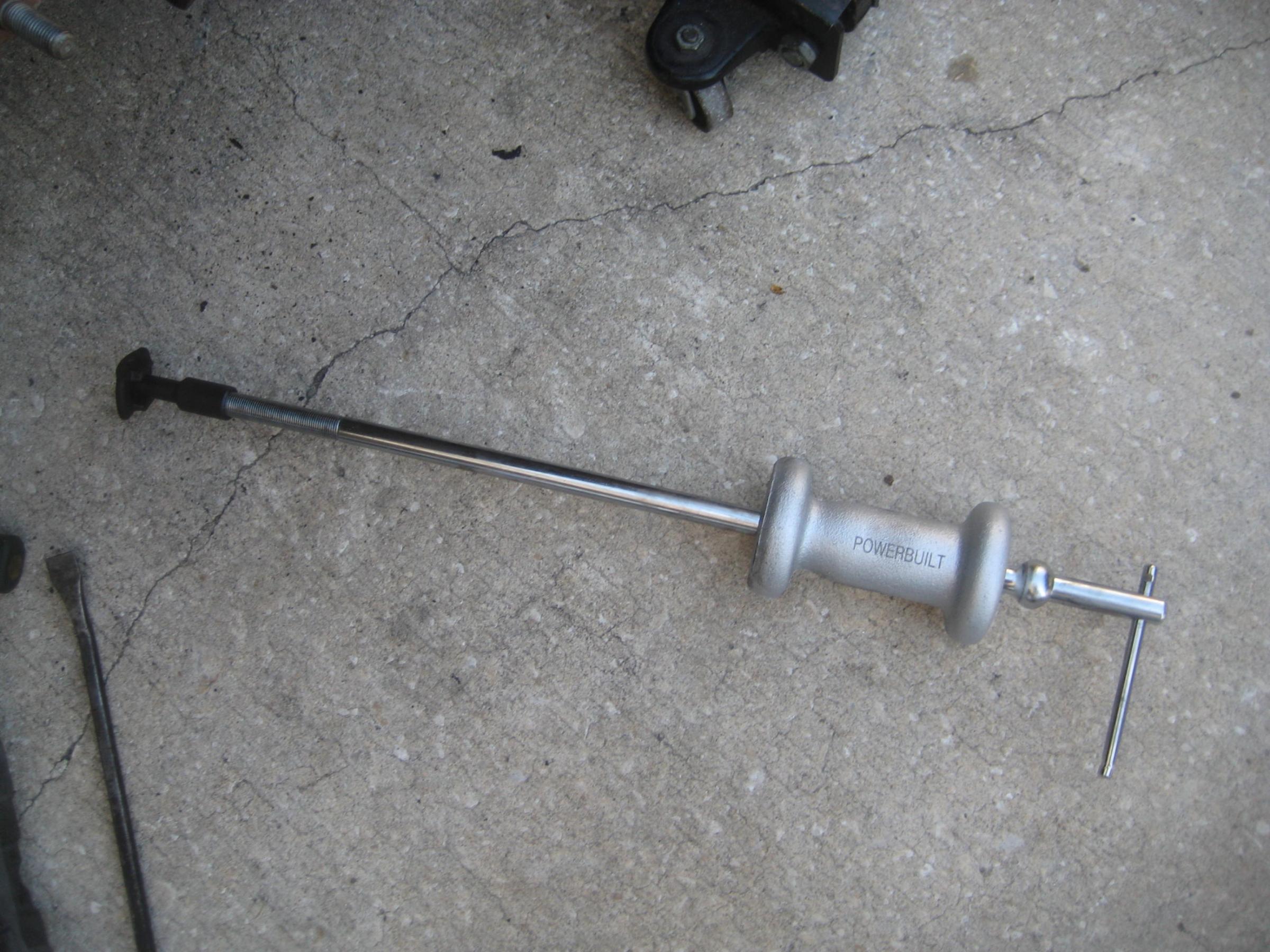

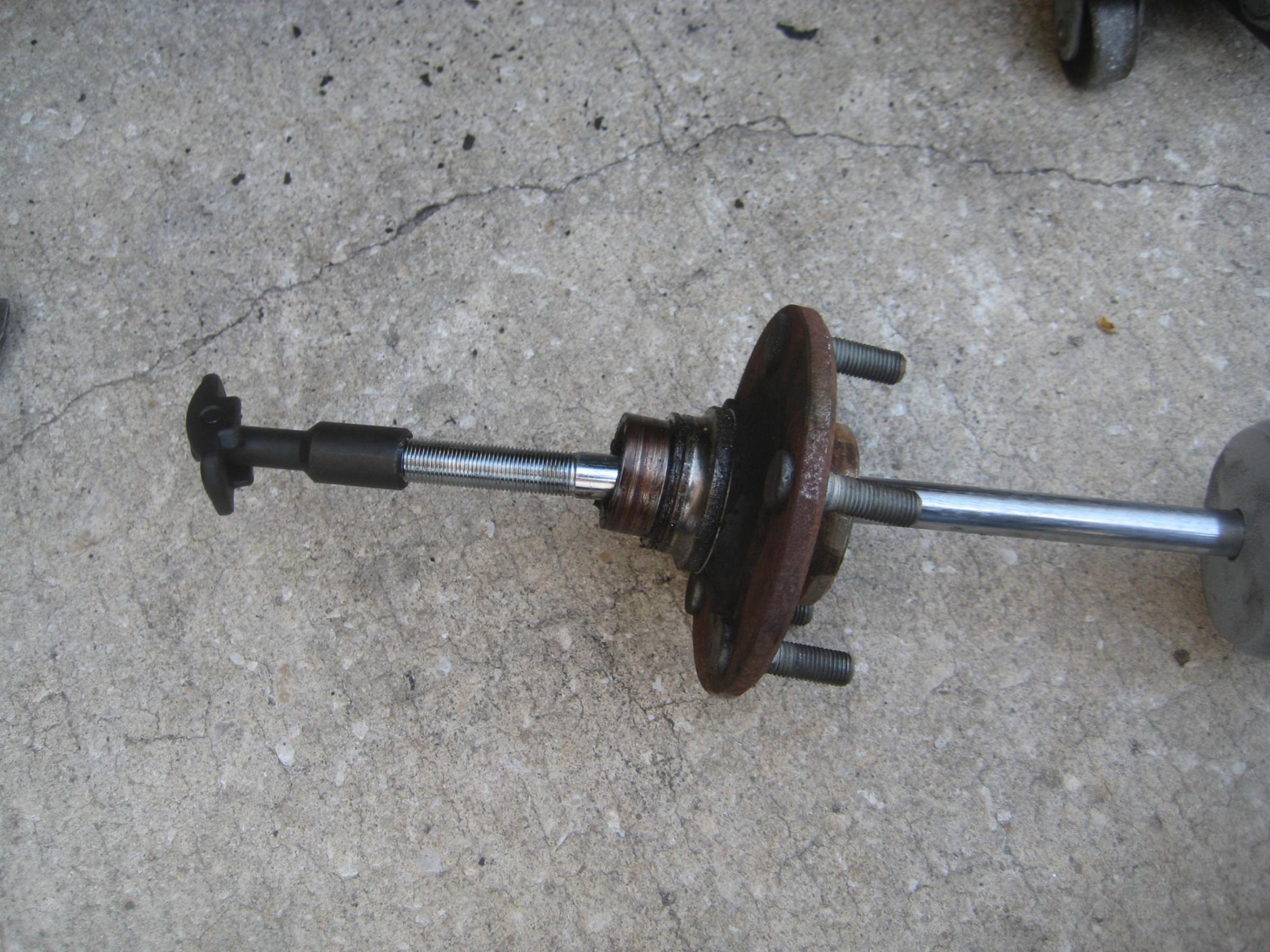

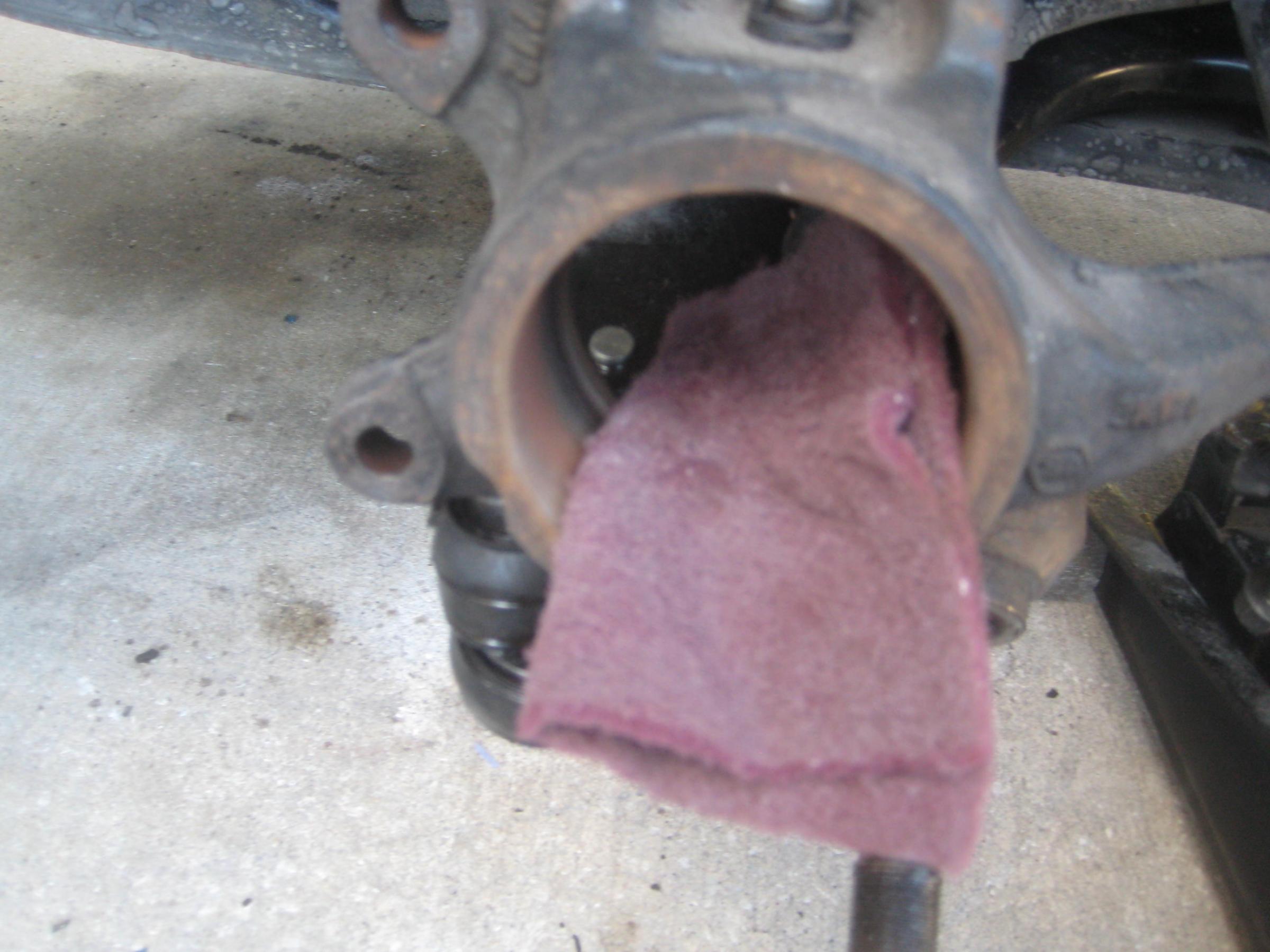

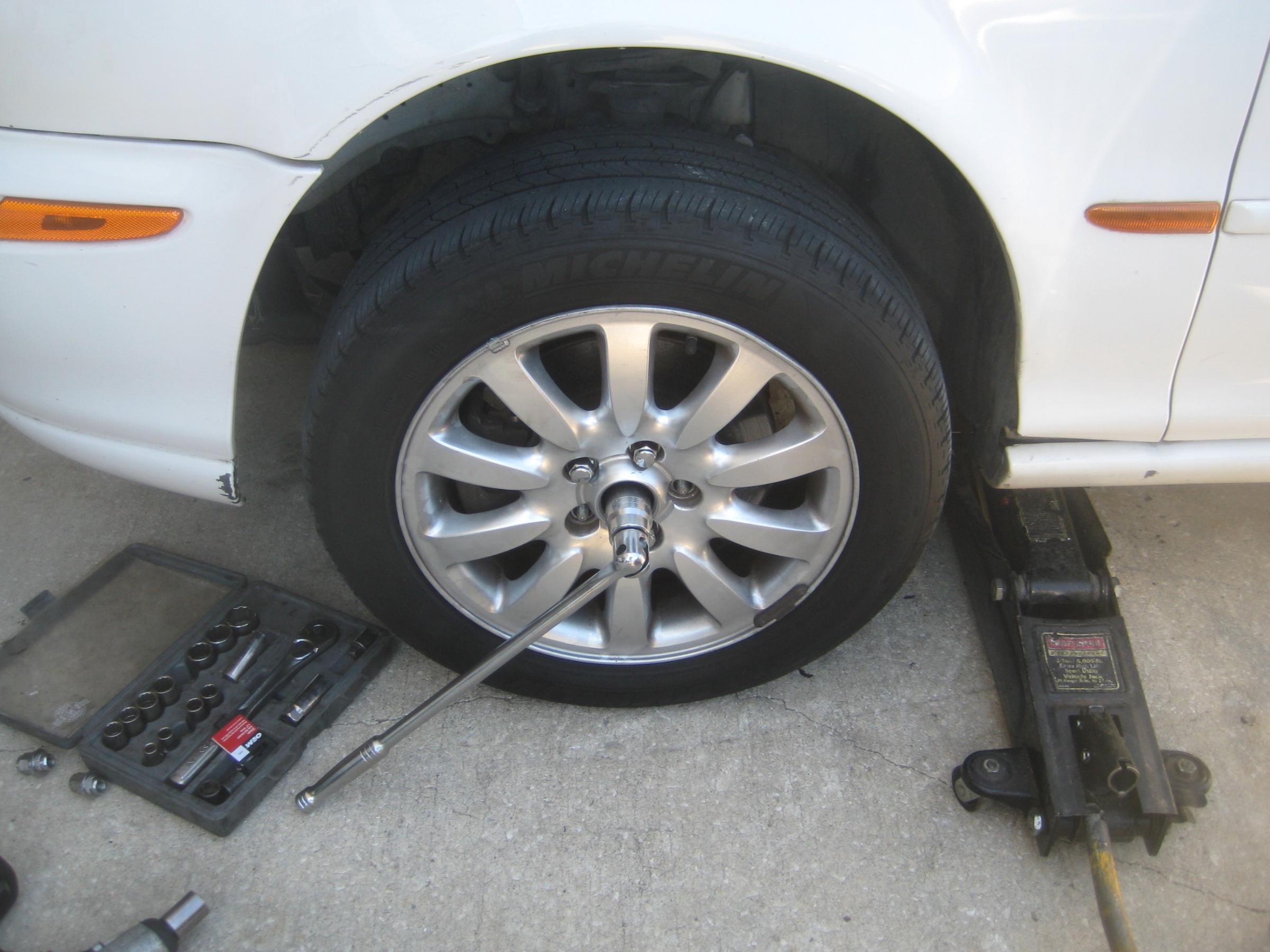

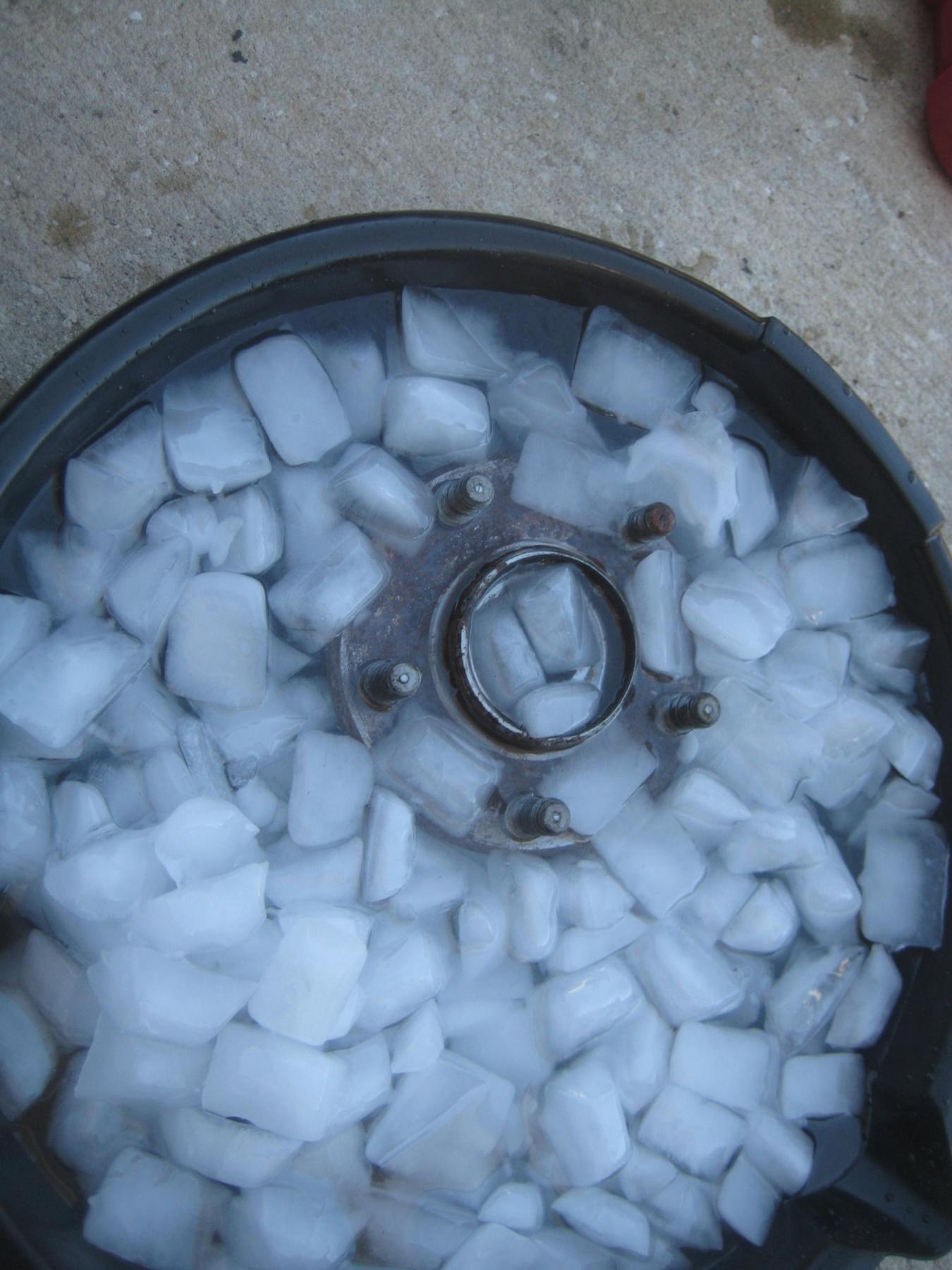

Got the wheel bearings on the front swapped. Took about 4 hours and I rented a wheel axle slide hammer kit from the local auto parts store.
Here some shots and a brief description of the order of how I changed them. You can use a press, or do it a bunch of different ways, but this is the method I use when a press isn't available and I'm crunched for time.
1. Remove tire, pop out center cap, and reinstall tire.
2. Use 32mm socket to remove C/V half-shaft nut.
3. Remove tire, put car on jack stands.
4. Loosen up outer tie rod nut and place jack under nut and lift up on jack until there is pressure on the tie rod end, after that hit the side of the tie rod mount with a hammer until the tie rod pops out.
5. Remove lower ball joint securing bolt and pry lower ball joint out of spindle. If you have trouble with this step you can always remove the 3 upper strut bolts and take out the entire assembly.
6. Remove brake caliper, mounting bracket, and rotor
7. Slide c/v half-shaft out of the bearing assembly.
8. Remove abs wheel speed sensor.
9. Use slide hammer to remove wheel hub from spindle.
10. Use slide hammer to remove wheel bearing outer part that is still in spindle.
11. Take small grinder and grind notch in inner bearing race that is stuck to the wheel hub. Use a chisel to crack bearing on the notch ground in the bearing. After that inner bearing race should slide right off hub.
12. Put hub in ice water.
13. Place bearing in boiling water. (put in ziplock bag if you don't want to get bearing wet.
14. Once hub is cold and bearing is hot install bearing on hub with rubber seal of bearing facing to the inside of the car (away from the hub) use old inner race to hammer it in.
15. Put new bearing and hub assembly in cold water.
16. Use torch to heat spindle where bearing presses in.
17. Once spindle is good and hot, and bearing/hub is cold use slide hammer to press two parts together.
18. Reassemble and enjoy your handiwork with a cold beer knowing that you did it yourself and saved a lot of $$.
