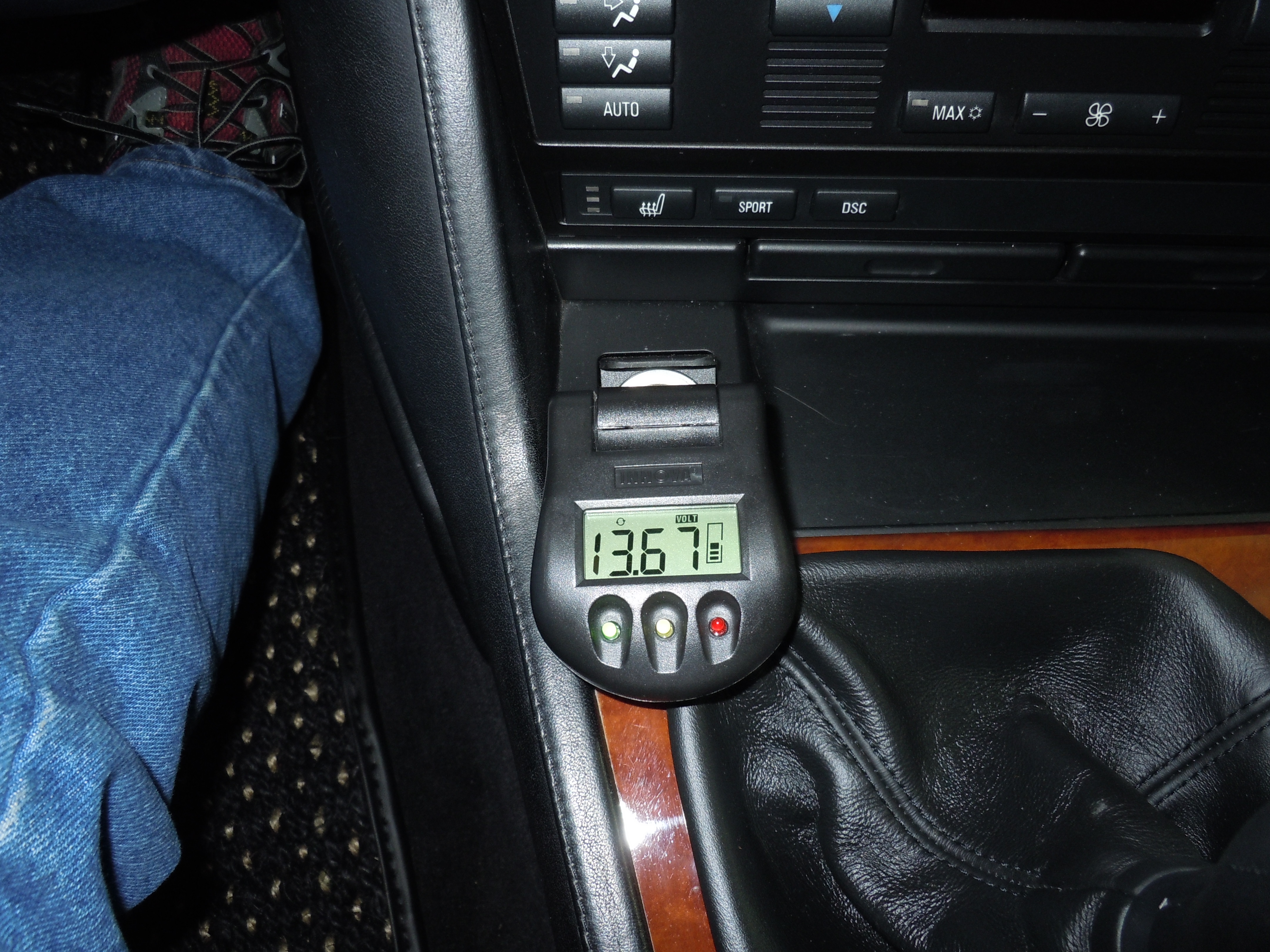

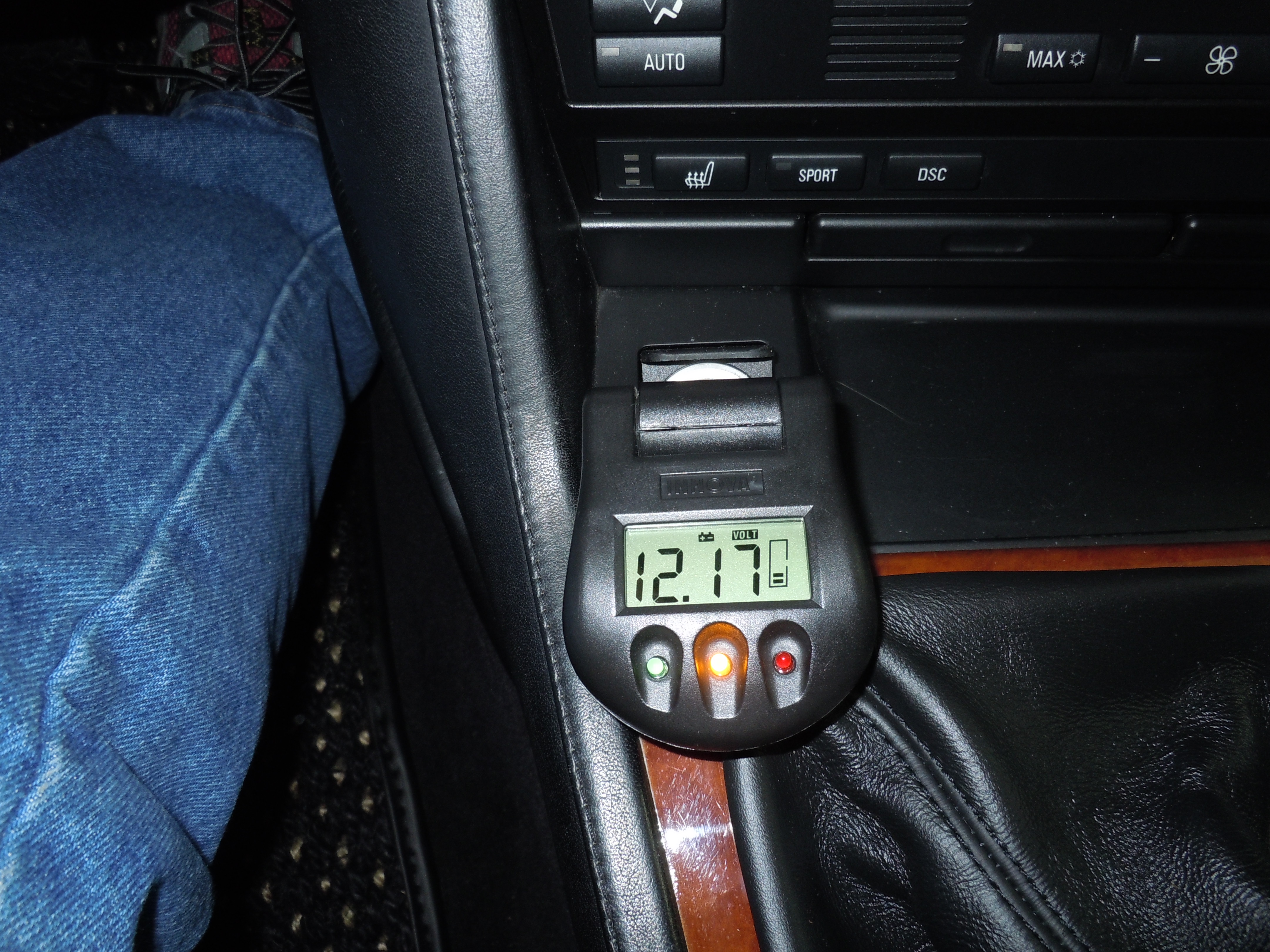

Pretty easy to check alternator function with a multimeter or one you can plug into the power port on console. With engine off check read voltage on battery terminals; then start engine and check voltage again. If voltage is noticeably greater with engine running your alternator's working.
Attached Thumbnails Got a noise from engine bay, help!-voltmtr.jpg   Got a noise from engine bay, help!-voltmtr1.jpg   Got a noise from engine bay, help!-voltmtr2.jpg

After I got the alternator out I observed that the die cast chassis of it was cracked, and it spun rough. Was certainly my problem, car is much quieter now.
My 1st x-type alt swap, took me about 4 hours in the dark to get it done. If they had just put the top alternator bolt in from the front that would have cut out an hours works(had to remove airbox and loosen coolant line supports(and cuss) to get to it.)
