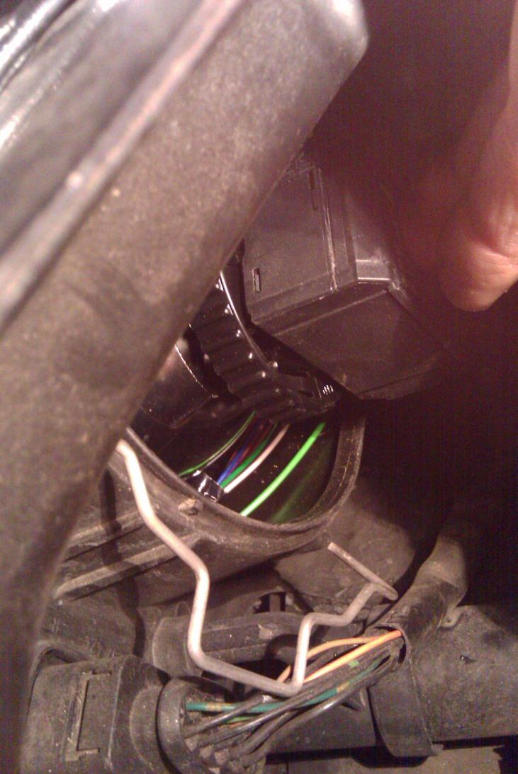

Good point. I thought all was good until I hit a minor bump in the road, then "blip" the light seemed to dip down and back up again. This morning I dug a little deeper. Here are the facts, and any help would be appreciated.
1) - The levelers are functioning fine, as well I start her up in the dark both sides dip and level back without any issues at all.
2) - Up until this morning, I have never taken the back covers off the assemblies and I've never replaced and bulb on her.
3) - I took the back cover off the pass side light this morning, and found that the HID assembly is loose. It seems that what ever would hold the actual HID system in place, has broken off the top.
I can place my fingers on the back of the HID and gently apply pressure on the back, and place it back into place. So now I have a HID assembly where the levelers seem to be functioning correctly, but actual HID housing seems to be separated from the rest of the headlight assembly. Any thoughts? And why do I have this sinking feeling that I'll have to drop the bumper to correct this?

Yes you have to drop the bumper to fix this....and the fix is to replace the headlight assembly
sorry i have tried to repair these and the plastic inside is just %$@*

Brutal: Thanks for the info. I was worried that I'd have to do that. I'm loading some pics as well.

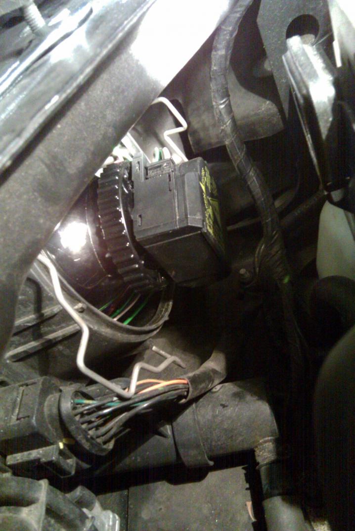

This is the 2nd of 2 pics. It's seems to just flop around, but the bottom half seems to still be attached.

its broken on the plastic posts that hold the assembly. its not totally broken which is why it still does/tries to auto level. I used to have many many sets of HID and halogen assemblies and tossed em all after not being able to get a good repair. Now if I had a machine shop........
