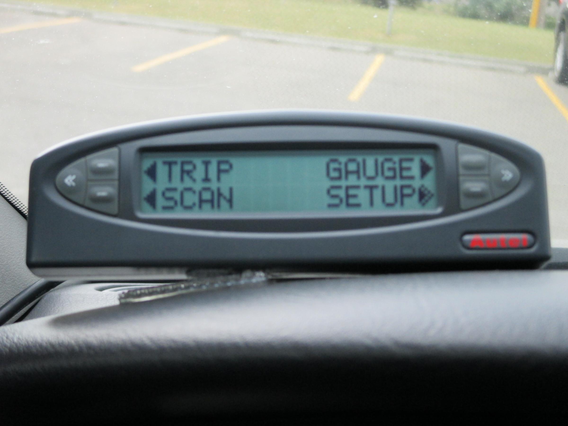

A couple names to look for are ELM327 (ODB-II reader via bluetooth) or a Scangauge/ autel maxitrip type of unit. Which also plugs into the OBD port however is a stand alone unit which you can mount in your car and which will read codes and clear them as well as has an interface to your computer like the ELM.
I have a Maxitrip (Chinese imitation) because I couldn't find a Scangauge (original product) locally. I'm fine with my imitation unit. I've cleared codes for my friends and it still reads live data and has a vehicle trip log for the last 20-30 trips I believe. Monitors air and coolant temps, it does alot that a larger more comprehensive unit will do so it's good to provide heads up anyways.
