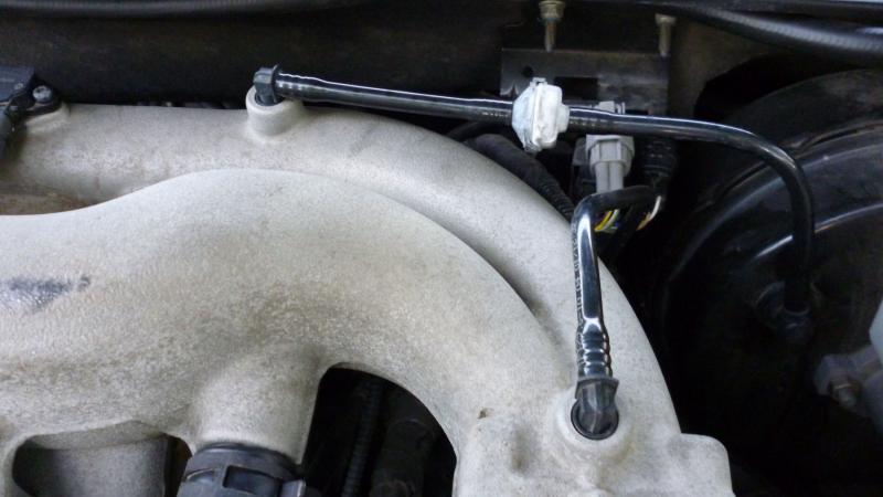

I've been chasing vacuum leaks at the engine & I found leakage where the two hard lines go into the top of the manifold, the lines are fairly new but the inserts that you push down to unlock these lines are worn...
What i'm wanting to know is, can these rings be purchased separately & can they be changed by a shadetree mechanic.
Thanks for any and all help/advice

Yes, the pieces are able to be replaced by just about anyone. I think you are going to find the hard part to be getting the new clips that go in there. I would recommend going to the local auto parts store and look in their miscellaneous parts area and see what you can find. I do not think that they come as part of a new hose assembly.

I inquired at the dealer. $15.00 for the kit, throw away the brass insert and use the rest,a do-it yourself job, in stock.

By the looks of your brake booster hose, you are leaking at the middle "bulb" in the hose, as it shouldn't look all white and cracked like that. If you don't want to buy a new brake booster hose ($70) then you can always get some large heat-shrink tubing and seal over that large area in the middle of the hose.

Should I find these pieces, do they install from outside, or do I have to remove the manifold & install from inside

The vac lines have what they call "Chinese fingers" to hold the line in,just push down the center and pull out the line, use a small screwdriver to fish out the "o ring" and holding fingers, insert the new one but don't use the brass sleeve because it's pressed in. No need to remove intake just don't break the hard plastic line, it's the "o ring" that drys out and leaks. If it's a long way to the dealer fish out the "o ring" take it to the hardware store with a good selection of "o rings" stick the "O ring" back in.( get the exact size) or you won't get the line back in, also there are black "o rings and there are green/ or greyish ones. Black ones don't hold up under heat as well as the others but at least you will know if it was the problem. Auto stores carry the ones for automotive use.A Hardware store usually has a good selection,grab a 1/2 dozen there cheap.
