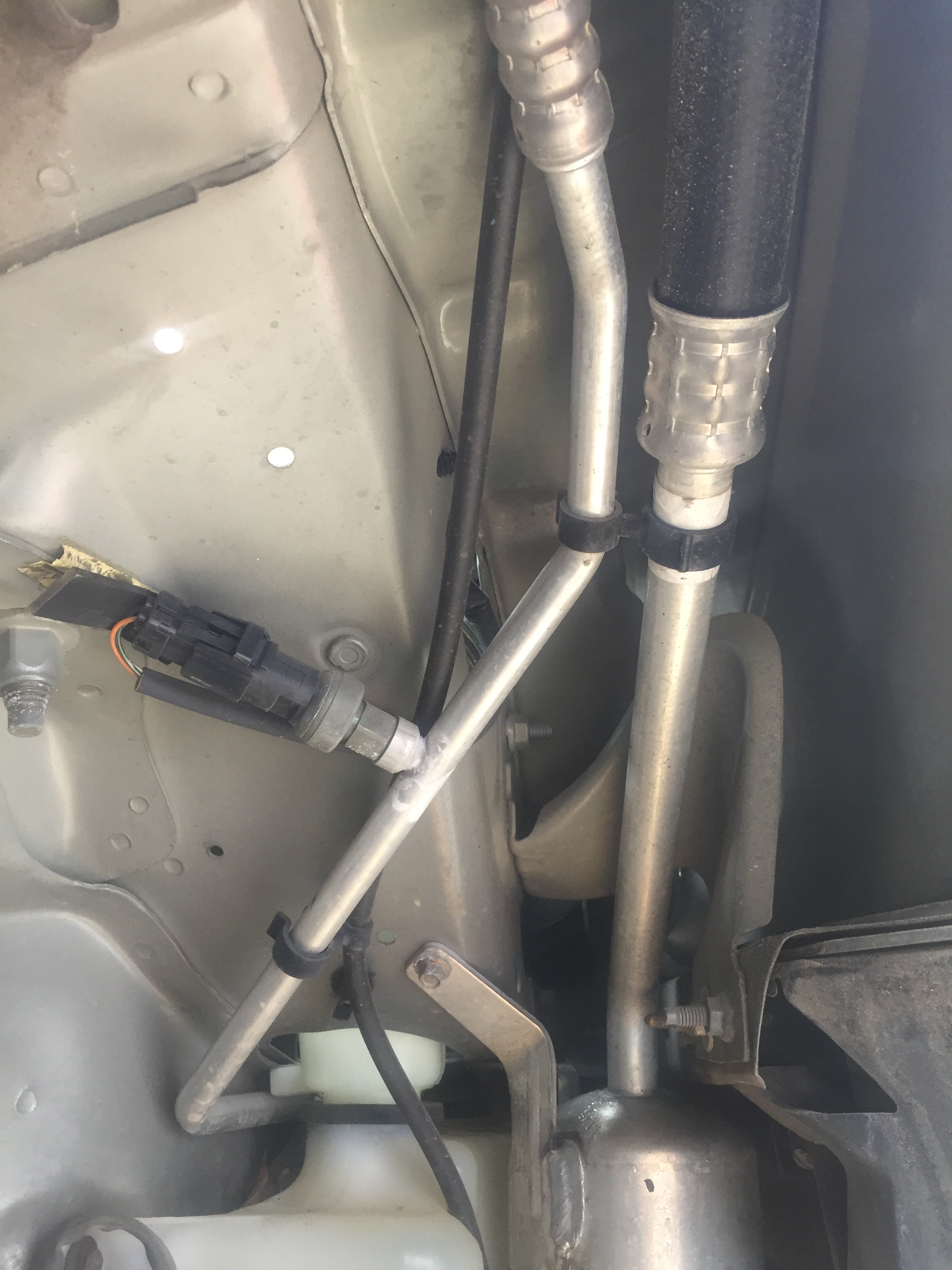

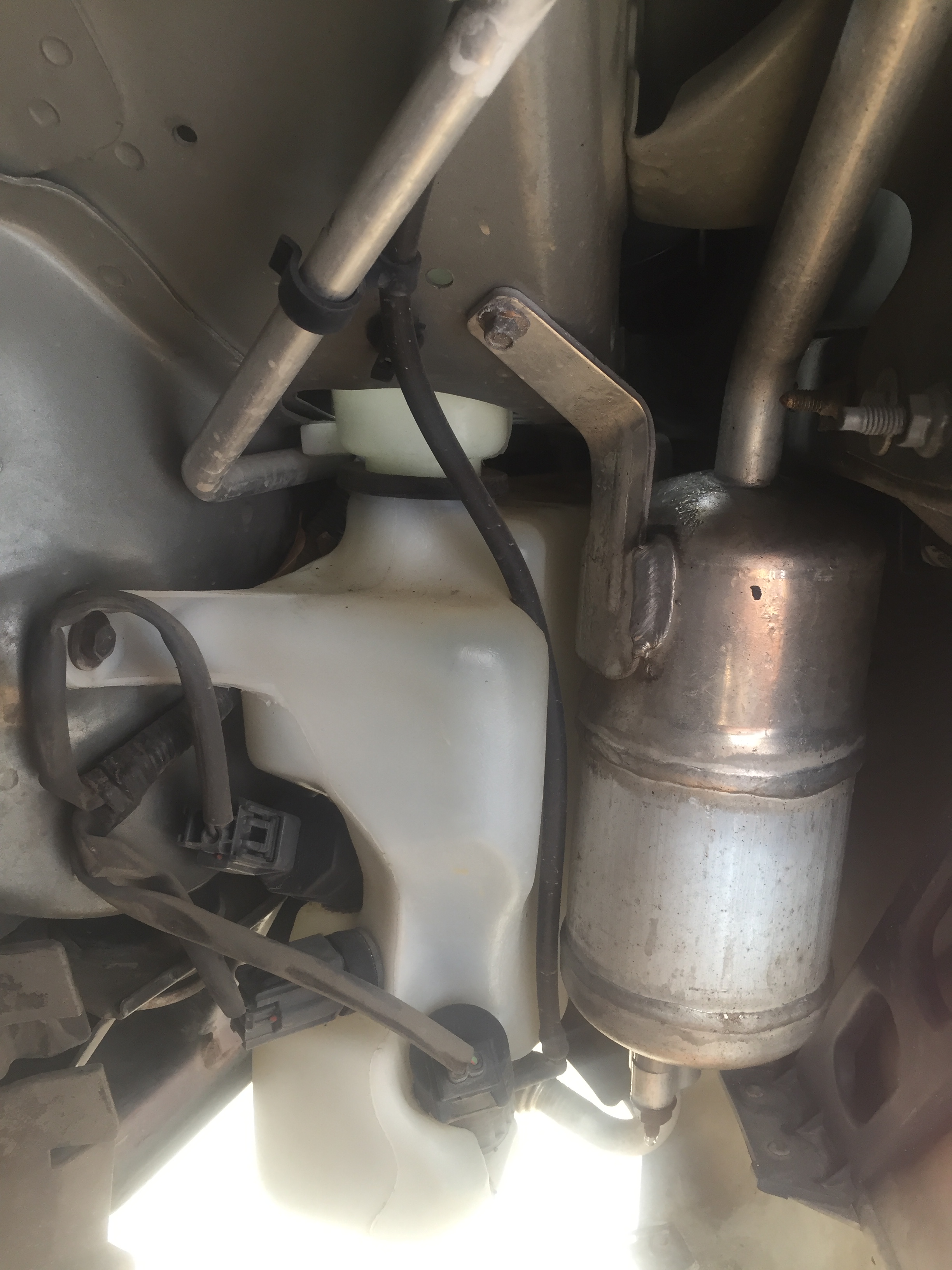

Continuing along Vern's train of thought, if you're losing Freon and searching for the leak, remove the right front tire and plastic liner inside that wheel well. This exposes the Freon drier / accumulator tank and 2 Freon lines from the compressor in the engine compartment, to the evaporator under the dash. These lines have several connections to inspect for leaks.
Presumably your mechanic already checked the condenser for leaks - in front of the radiator where it's in the line of fire for highway debris.
