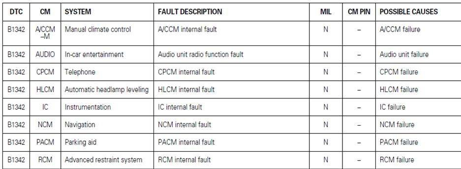

Hi i want to ask on x type diesel engine face lift year 2007 how to see injector feedback on live data, and also,
when i click on live data i see no values , also why these errors cant be cleared ? i clear them but they are not cleared.
Jaguar errorrs which dont want to clear,

I think the U codes indicate CAN Bus problems so I am not surprised you aren't seeing data. That B1342 error indicates the problem is the modules for phone, navigation, restraints, etc. The B2292 points directly to the RCM, restraint control module. If you can unplug that RCM you might find it is misbehaving and causing communication errors.
