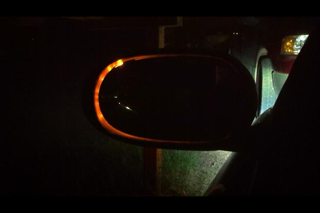

might just get those for mine!! got some LED strip lights at Autozone and installed them behind the side mirrors. can't really see them during the day but it looks awesome at night. Gives a nice lil glow around the mirror when the turn signal is on. i'll try to post pics later on.

i hope i uploaded it right, here is the pic of the side mirrors. i ended up placing the LED light strip behind the mirror and got a cool glow. it's hooked up with the side marker light so it blinks when i use the turn signal or the hazards. and you can't really see the hardware. best $15 i ever wasted!!
Wow! That looks great, I'll have to look into doing that on mine
Yeah, let me know what you had to do for the mirror rope lights. That's a great idea. Unfortunately for me, it seems I may have broke my headlight assembly when attempting to replace my high beam bulbs, so that's top of my list now.

i got the LED's at my local Autozone. Here is the link:
Alpena/8 in. amber colorful flexible LED light (77444) | LED Exterior Accessories | AutoZone.com
i put these on my Expedition as well but as the quarter lights and the white ones.
I just pasted them on the inside outer curve and ran the wires along the wire harness of the side mirrors. I'll take pics of the side mirror later. I did have to take off the back covers, the door panel, and figure out how to run the wires. It's a half day job ( once you figure the first one out)
