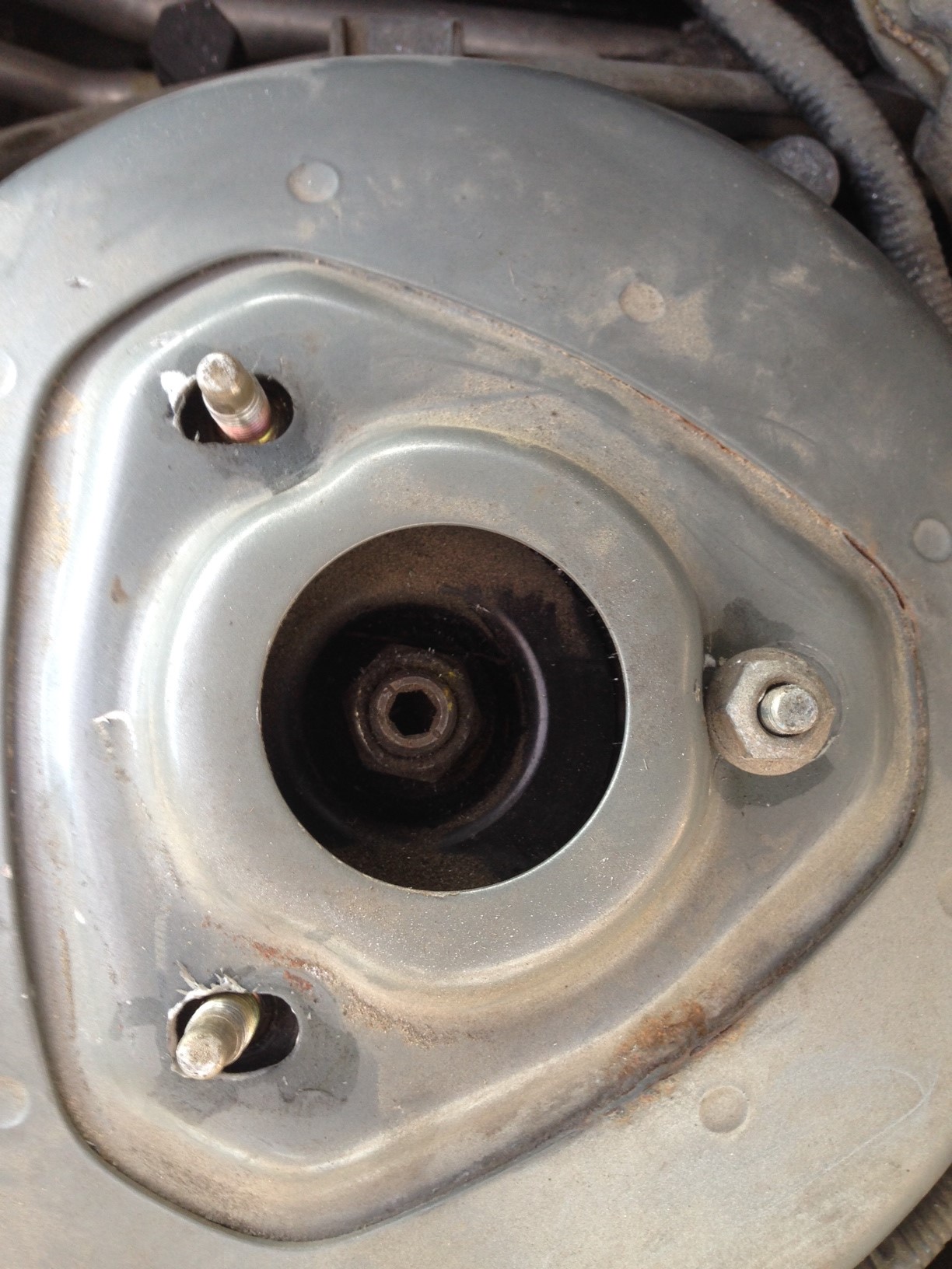

Yes, at ~125K miles the ride is tighter, quieter & smoother. I can't judge how much improvement resulted from new tires, rear upper or rear lower control arms, since I replaced all three at the same time. But the result is definitely an improved ride, and the tires now wear evenly, staying balanced longer, with less road noise and vibration.
I also fixed excess negative camber in the front suspension. The factory does not provide any way to adjust front camber. So as the bushings wear, you get too much negative camber, i.e., the tops of the tires tilt inward, causing the inner tread to wear prematurely. The proper long-term solution is new front control arms. But as a quick fix, I elongated the holes in the strut towers and brought the front camber back to spec - see attached pic.
