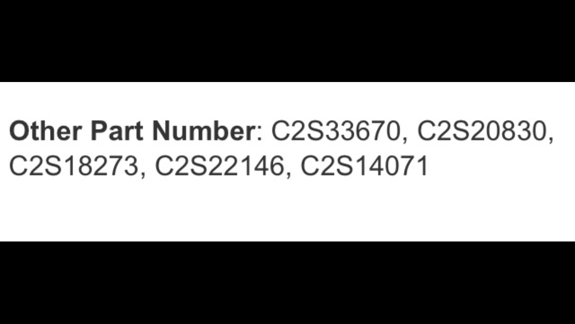

Old Sep 15, 2018 | 08:35 PM
  #30
iownme's Avatar
Joined: May 2011
Posts: 1,741
Likes: 174
From: ga
the 2 i found on ebay have the same part number EXCEPT for the last letter
in the listing one shows the car had nav, the other doesnt mention it.

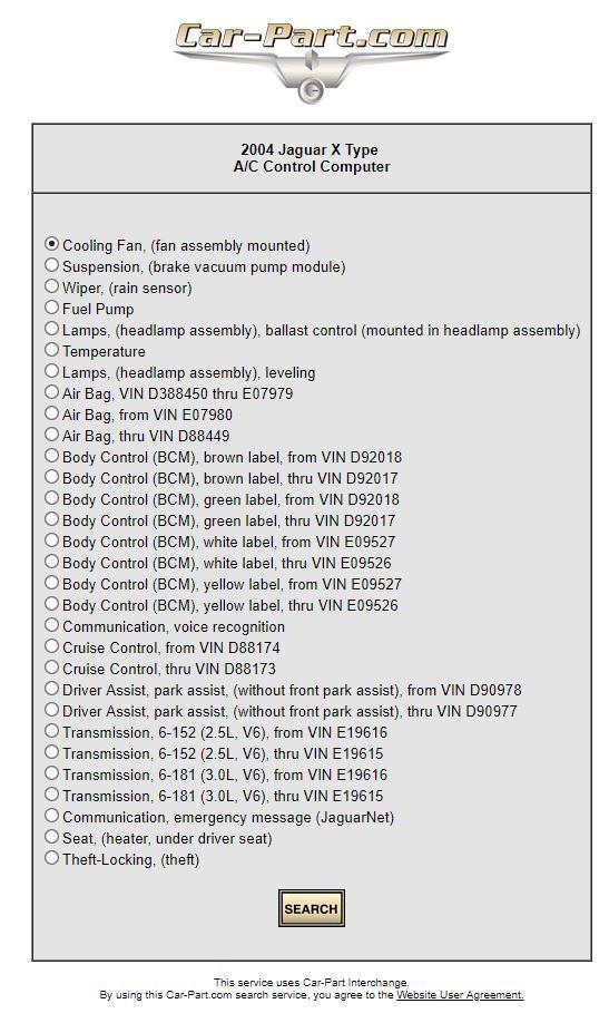

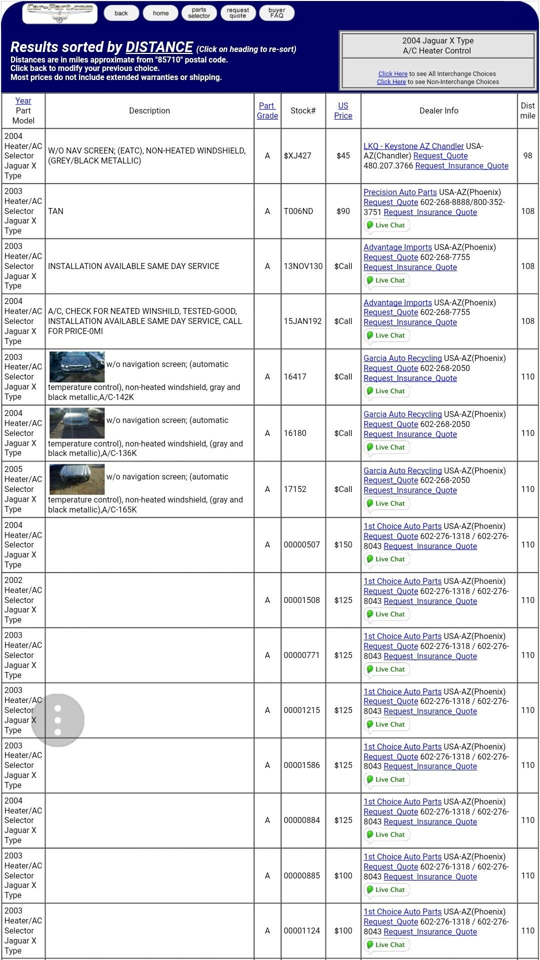

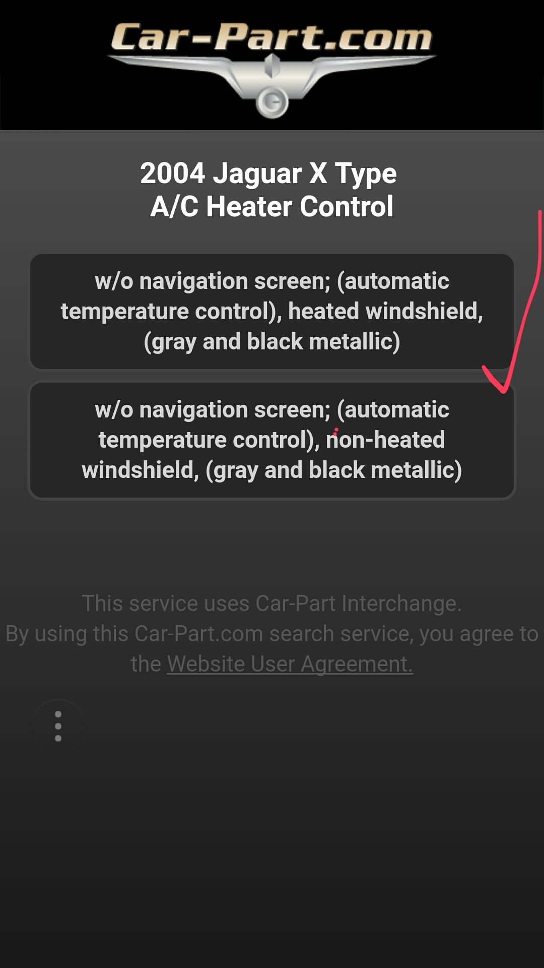

Old Sep 15, 2018 | 09:04 PM
  #31
aznewsh's Avatar
Joined: Jan 2011
Posts: 70
From: Tucson, Arizona
This is so confusing, the same part seems to have about 10 different part numbers, Thermo states that the nav ones are different which makes sense so I just got to figure out a used one that comes off a non nav, the one you linked above has nav so won't work...I think!
If I can find a used one off a non nav for these prices I will order it.

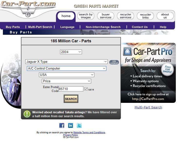

Tried the Car-Parts.com website and when I fill out the search like this:
If I then click search - I get this:
That makes no sense to me

You didn't search correctly =

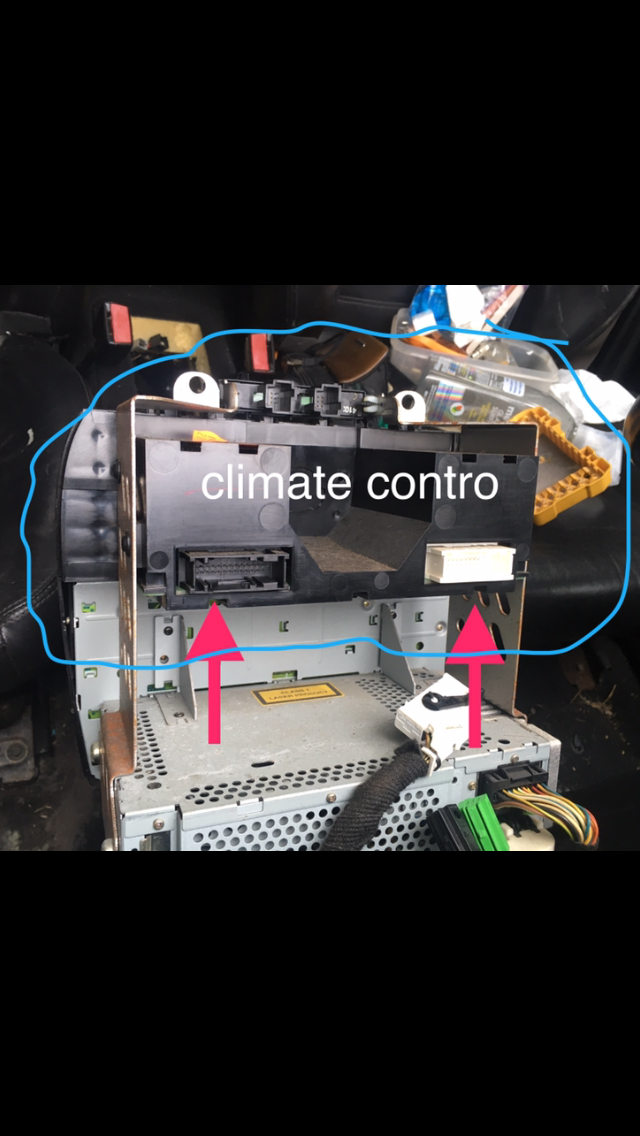

Old Sep 16, 2018 | 07:50 AM
  #37
iownme's Avatar
Joined: May 2011
Posts: 1,741
Likes: 174
From: ga
that makes sense and u just solved a question i had....(and the whole nav/non nav riddle)
i just went out to my 04 parts (non nav) car and took out the stereo/a/c controls to see what part number my ccm had.....there is no seperate ccm there....it has the two same black and white connectors in the back of the ac control panel as the seperate ccm's have, which had me wondering where the ccm actually was!.
so he needs to buy the actual control panel, not the seperate ccm which dell and i have been searching for.
new ebay links coming soon ...haha

Old Sep 16, 2018 | 08:21 AM
  #38
iownme's Avatar
Joined: May 2011
Posts: 1,741
Likes: 174
From: ga
my 04 non nav unit circled in blue.
arrows point to connectors
