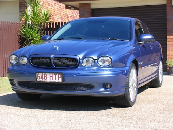

Hmmm, I expected problems like this when I did mine. (lower Mesh Grille)
So, rather than spend an inordinate amount to buy something that won't fit properly... I felt it was time to be more innovative.
See the pics attached .... only cost me a few bucks for the parts and I think it looks just great. (and no more rattling Louvre)

Lcgi, are you saying you made that yourself? If so, great job!

Yep, all made at home with prepainted mesh panel and rubber extrusion for the perimeter fixing - all secured in place by a bead of Silicone Adhesive applied on inside bumper cover. (no rattles no corrosion)
Costs;
Mesh Panel: $18.00 (48" x 6")
Rubber Extrusion: 11.00
Tube of Silicone: 5.00
Total under $35
My Labour to Make and Install about = 4 hrs.
Best thing is, if I ever need to revert back to the Louvre (unlikely) all I have to do is run a Box Cutter blade around the outside of the extrusion - to release the grip of the silicone.

I may have to remove my screws and just do silicone. How long has yours been on the car? How strong is the hold?

Mine has been in place for around 6 months now.... believe me, the strength, grip and durability of silicone - is more than substantial.
I used this product;
Selleys Wet Area Silicone - Silicone Sealants | Selleys Australia
But, do doubt you will have similar/alternate silicone products - in your neck of the woods.
If the screws you mention are holding the grille in the correct position.... then I suggest you apply a good 6-8mm fillet bead of silicone to the inside of the 'front bumper cover' where it interfaces with the grille.
Once your bead of silicone has fully cured... perhaps you can remove the screws.
Good Luck....
