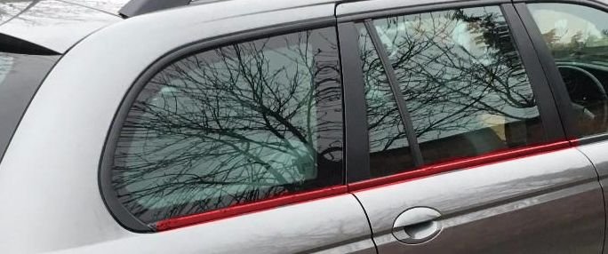

are the seals shown in red replaceable and if so are they clip or stuck on?
any pointers where to get replacements gratefully accepted
thanks

Download the SNG Barrett catalog for the x-type ( forum sponsor) and you will find them listed on page 83. You have to remove the vertical pillar trims then the waist seals pry off.

Also, you may want to wait and see how this goes
Window / Door Trims - What Are They Called
This is what is being used
Small Car Finned Rubber EDGE TRIM SEAL - Van Boat Truck Caravan - Door Bonnet | eBay
One image has the measurements if you are not in the UK
