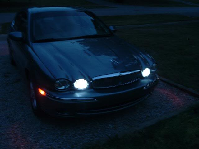

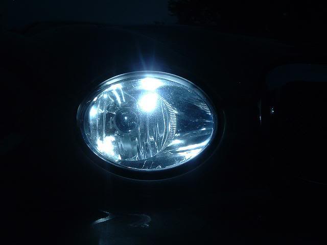

As I mentioned in another thread, I had a electronically-savvy friend of mine whip up some "custom made" LEDs for the city lights to match the new HIDs. Even with the stock headlights the horrible yellow color to the city lights drove me crazy.
Here are the new blue/white city lights with STOCK headlights, for reference.

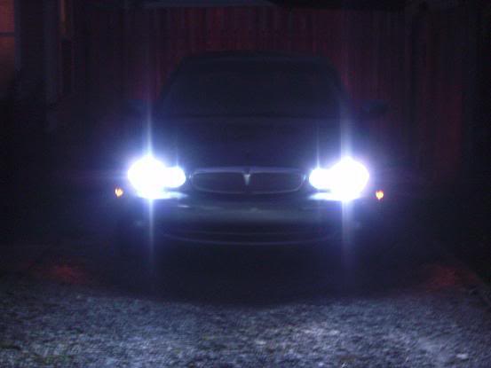

Also, I finally got a chance to install my HID kit, and I LOVE it.
The kit was very straight forward (despite the rubbish instructions), and actually kind of fun to install. The hardest part is deciding where to mount the balasts, but I think I did a good job. So without further adue..
The kit itself, 8000k in color/temp, and is *not* as blue as people may think.

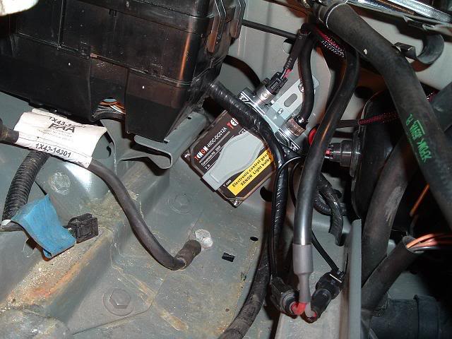

I mounted the left ballast in a small open compartment infront on the battery, inside the fender. I'll let the pictures speak for themselves.

I had a tough time finding a place to mount the right side ballast, but found a nice spot away from the direct heat of the engine. The power steering fluid resivoir mounts to a bracket infront of the shock tower. Also on this bracet are a couple ground wires for other engine components. I put a 90* twist the bracket for the ballast, and mounted it to the other bracket using the bolt holding those ground wires down. If you look in your engine bay you'll just what I meant. I zip-tied it to the brake lines, and fitted a small piece of rubber between the two to help isolate and vibration or wear on the lines.

I believe this area is the toughest to get to on the car. You have to have incredibly small hands, and be willing to bleed.

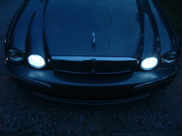

I had a chance to take a few new pics tonight (hopefully) giving everyone an idea of how the 8k lights look. They're not the best, but they're a little better than the previous ones. enjoy!
