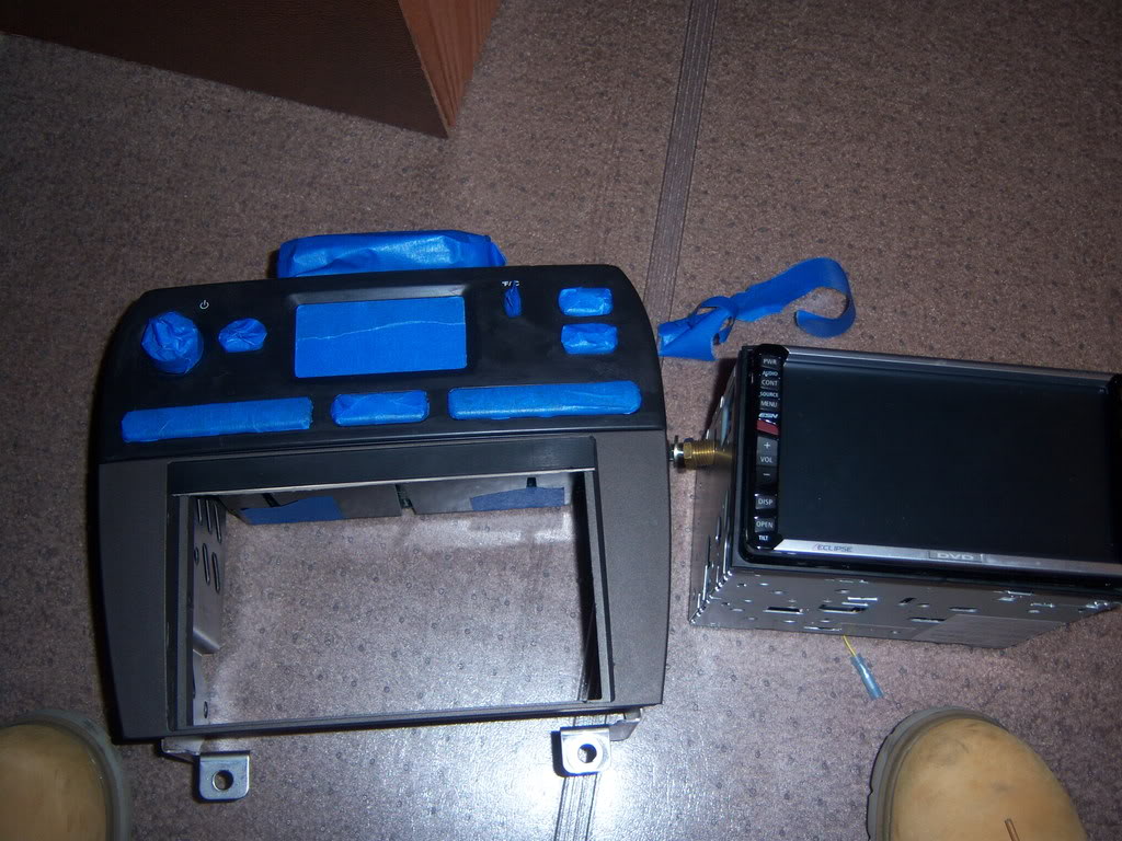

Dennis, from the pics the nexxia fascia looks gray, like my stock dash. Is that right? I see you painted yours black which I am guessing is the color of your stock dash. just wondering what color your fascia came in.
Fixit, hope this all works out for you. looks like you are going to be the guinea pig because I am not going to get around to this until after Xmas unfortunately. I'm crossing my fingers for you and if it isn't too much trouble, please give us the details as you go through it. Funny, you are in PA, I am too, in Harrisburg. I see you are around where I got my Jag, near Allentown. Small world.
when my fascia came to me from nexxia it was a little grey...so the trick is the color code of the black x-type is [ped] so i have a place were i live who can put your exterior color in a spray can and spray very fine ....it comes out perfect...but when you order your fascia you maybe lucky and its the same color as your console ...if any problems with color you can order the paint...its a real easy job

Sorry for the slow reply...kinda busy this time of the year....anyway...no complaints with Avic F90BT....I got ( 2 ) of them...one in the Jag & one in the Rav4....I'll tell U the best feature for me is the bluetooth...though I must add (sometimes) when you use voice commands it does not dial the correct phone # or play the right album from my ipod...not a big deal though...just press in the volume knob and it cancels the command....I guess it just must take practice...my wife uses it all the time and it always works for her...what the ***...haha.
Anyway back to the install...I'm sure you viewed my install thread...honest because I had no idea what I was in for I say it was a challange...but if you are handy you will have no issues...just check my thread and get the parts I ordered....In my pics you will see I made spacers I made out of plastic to shim between the cage and the headunit....you could use anything...just need to sturdy the unit with the shims.
Steering wheel controler is still working perfect...very nice to have this work....get the one I ordered.
Yes the unit will stick out unless you open the facia like I did and allow the front of the headunit to slide through it...I measured & did this with a torch and a hot knife to open the facia plate till the radio sliped through it....I left the cage to radio mounting bolts loose..once you do that the whole thing slipped right in to the dash and positioned itself...I then pulled it back out and tightened all the bolts securing the radio to the cage...I was not so good with the hot knife so that is why I made that little frame to cover my mistakes when the plastic melted...all in all it sticks out roughly 1/2" and the ashtray door opens fully.

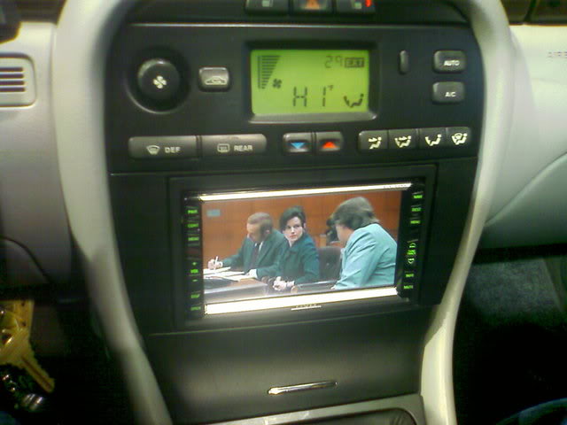

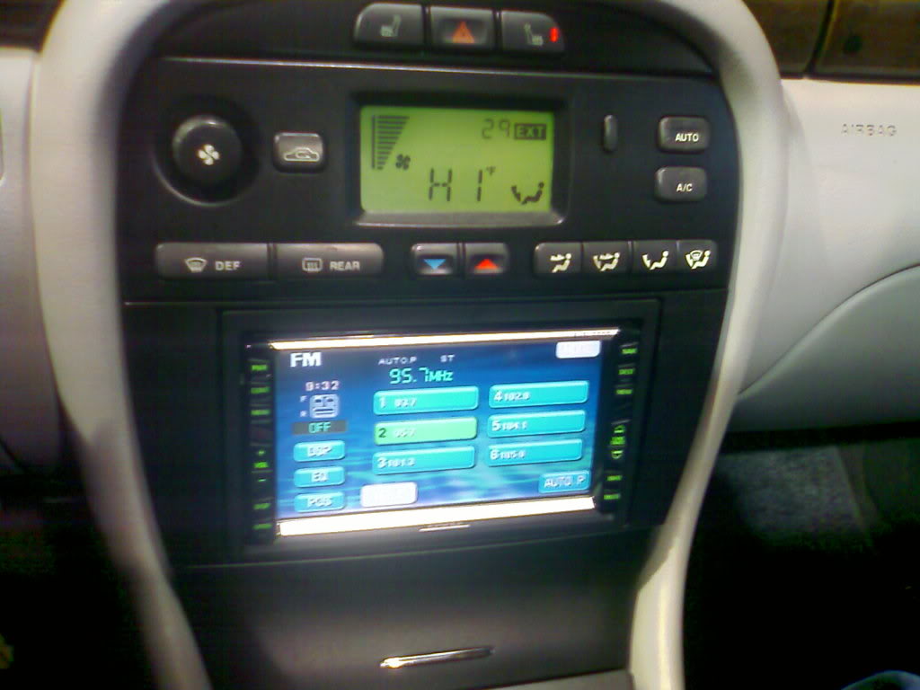

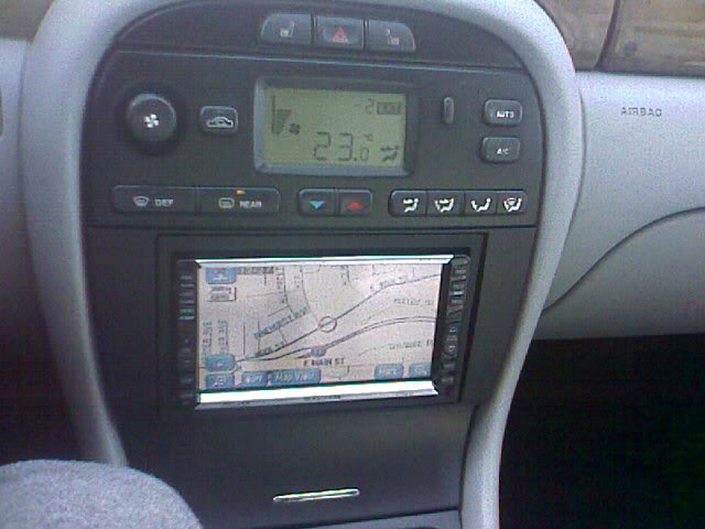

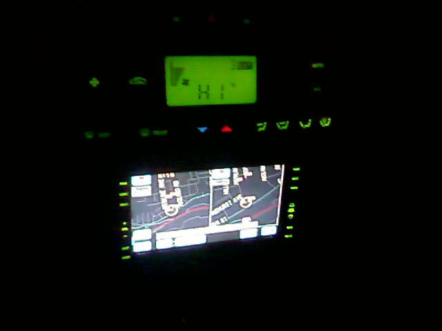

Here are my last photos I promised of the finished system. Sorry it took so long to get them up here.
Special thanks to Dennis for providing a wealth of info on our cars. Makes life a bit easier when you have an insight on what you are up against.
My camera is as old as me...excuse the quality of pics

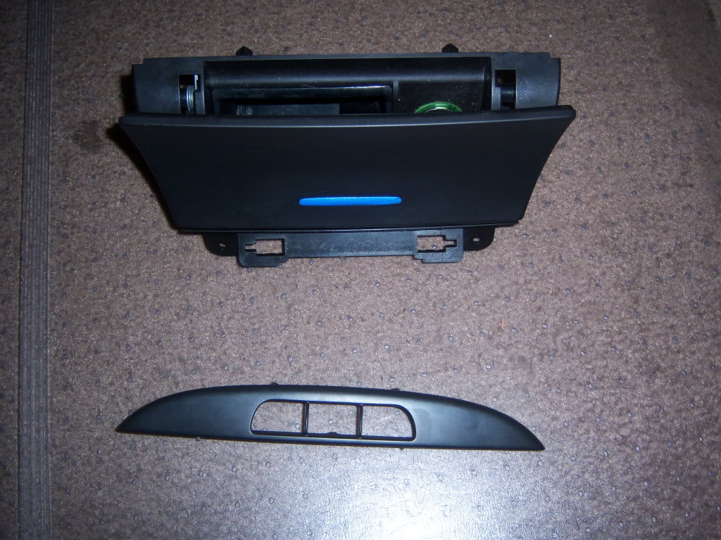

Ashtray door opens fully. I know alot of people have this issue.
One of the best features i enjoy...Ipod hookup..I hid it in the center console.
MTX 12" subs & mono amp...1200 peak watts...yeah right...took alot of trial and error to tune them..killed the bass adjustment on the headunit & they now sound clean & tight..next it took me 30 days to cure the trunk rattles. Finally good to go..
