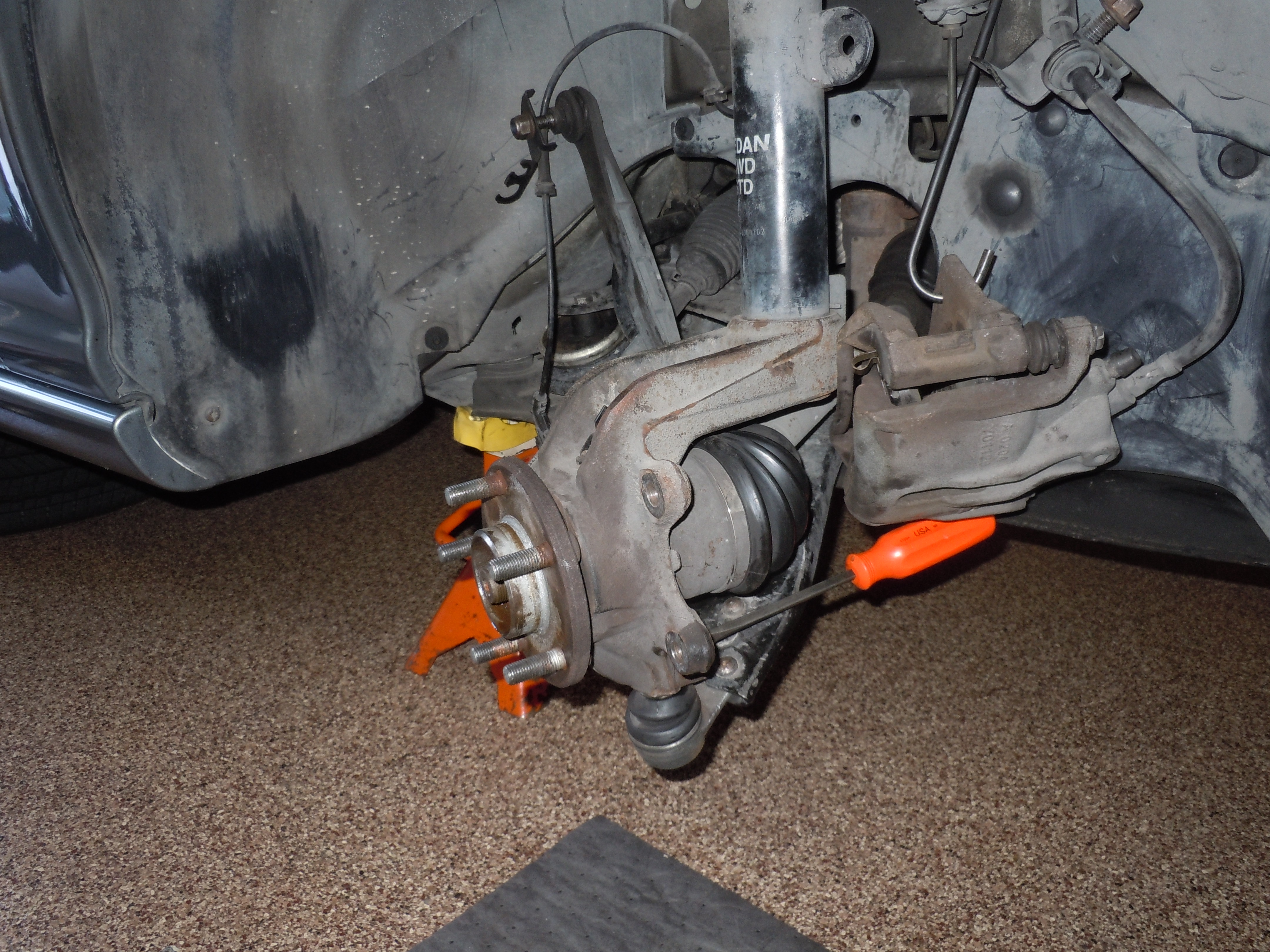

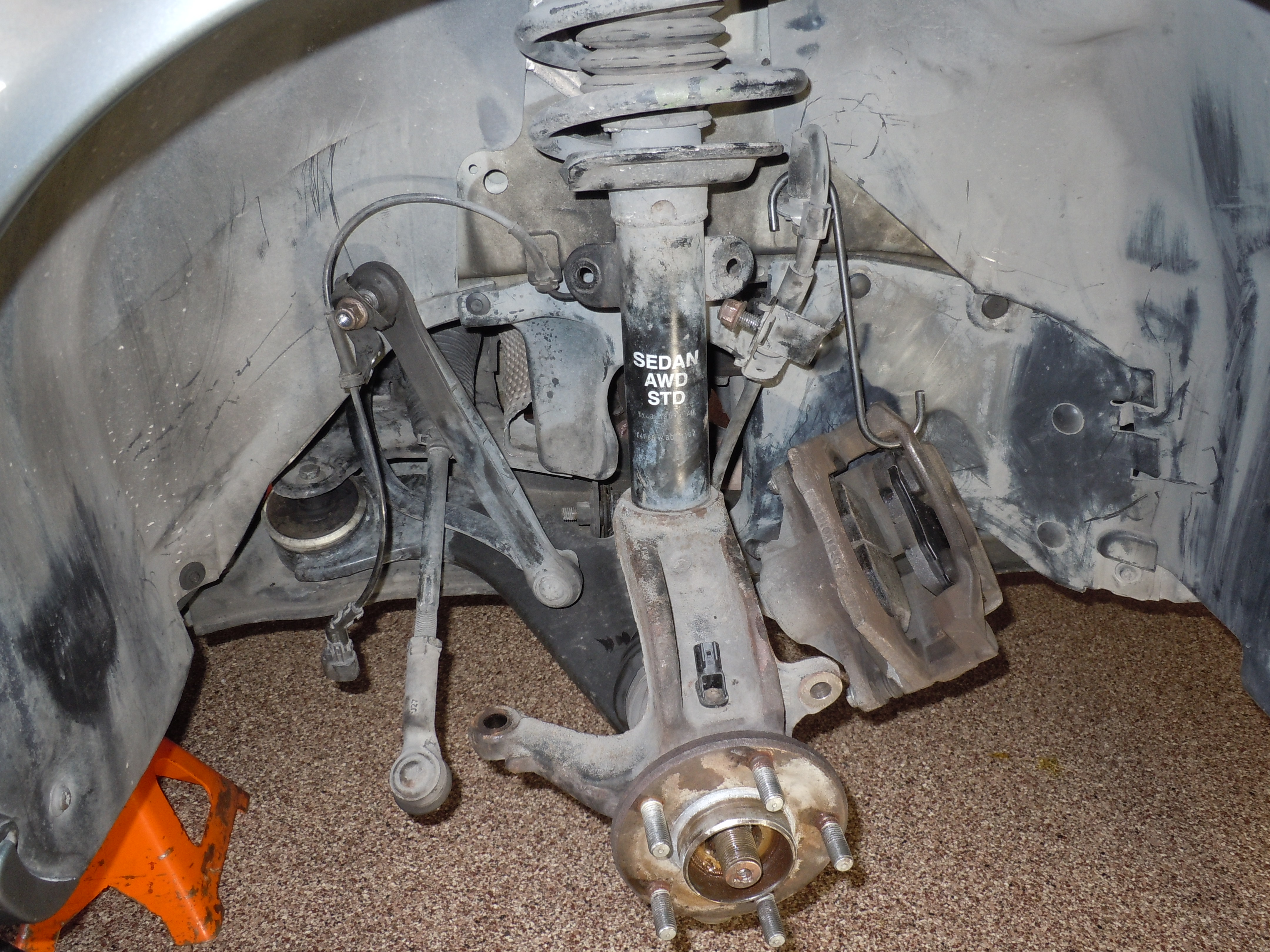

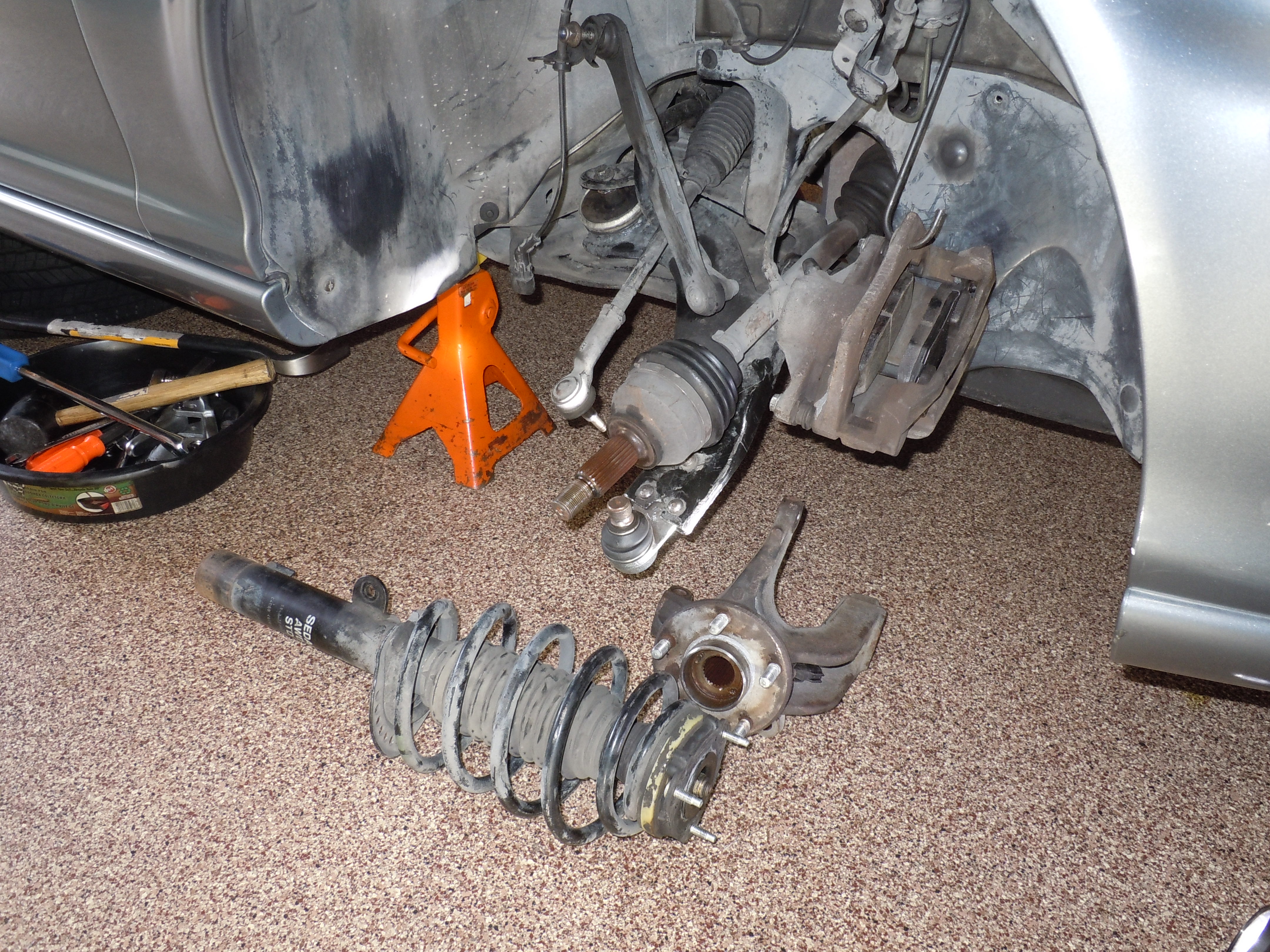

I had the same problem when changing front struts on my '04, and am trying to recall how I got it free. I do remember lifting the knuckle slightly with a jack to give that pin more clearance. I did get it out but it was a fight. Think I also used a long pry bar. When you get the knuckle out you'll have to replace the whole lower control arm, as the ball joint is not available separately. I bought a control arm from Rock Auto, made by German manufacturer Meyle. I had to buy it because the large rubber bushing at rear of arm is oil-filled and will crack open if you overstress it. I have that t-shirt from doing the left side strut.
