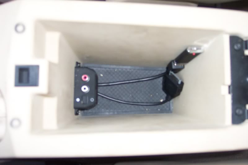

The dealer installed the ACM, or audio control module, about a year ago or so. The link to the part on the JAguar site is http://www.jaguarusa.com/US/EN/_glos...ity_module.htmThis is what it looks like installed:

The system really does sound better than any cd player you will have, but that is dependant on the quality of the mp3 files you have. All of mine are encoded at 320k and all are crystal clear. It does have it's drawbacks though. While there is an rca input, don't use it. The internals of the ACM were not perfected before it was released and I have had mine repaired or replaced 5 times in the past year. Every time I have used the rca it plays the audio fine, but as soon as i turn the car off and the unit loses power it fries internally. I mean literally fries - it was black and burned. The oficial "fix" from jaguar was to tell me that i needed a signal reducing cable to lower the input to the ACM via rca. Just to prove a point I went down the road to a bestbuy and bought a cable, then drove straight back to the ******* and let them SHOW me how to do it the right way. Like you could have guessed, as soon as they turned off the car and unplugged the rca input the unit fried again. This isn't a big factor for me as I bought the unit for the sole purpose of using the usb input, but it may be for you. (I just read the link I posted above from Jaguar and it seems as if they have changed from an rca input to a headphone jack).
Jaguar rates the unit at 1 hour of labor to install. When I got mine it was on sale for $252 plus 1 hour of labor but I have heard that prices have gone up since. Let me know if you need any more info.

Is it me or does it look all most identical tothe Mazda's unit? I realize that the pins may be different, afterall Mazda's stereo is made by Blose, I mean Bose.Just food for thought....

the only similarity would be that both systems have an ipod connector.

Unfortunately that is the only pic provided but I've seen them in person my friend installed one in his Mazda6 and he even has it in the same spot.

Mounting locations vary, I just chose to have mine there as most people do with aftermarket items - out of view. The Jag system has 3 inputs and is fiber optic, 2 thing I believe the Mazda system doesn't have. Jaguar is the only system I have ever owned that is run entirely on a fiberoptic network.
