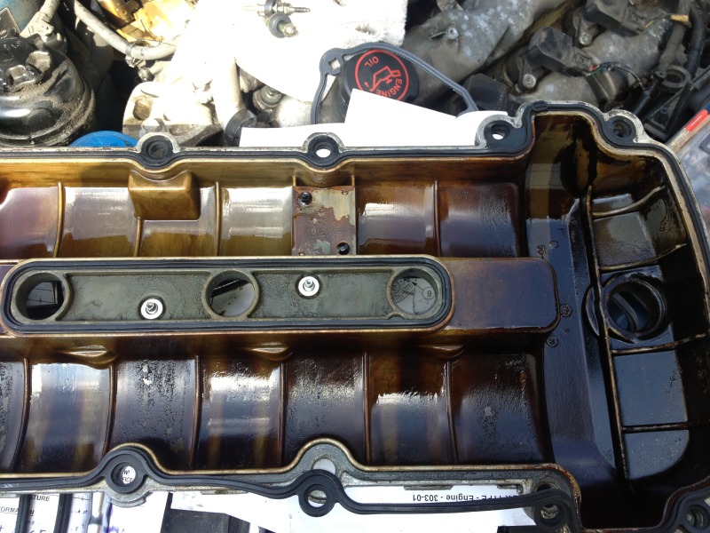

Replacing valve cover seals and spark plug boss seals
Jaguar X-Type, 2002, 2.5

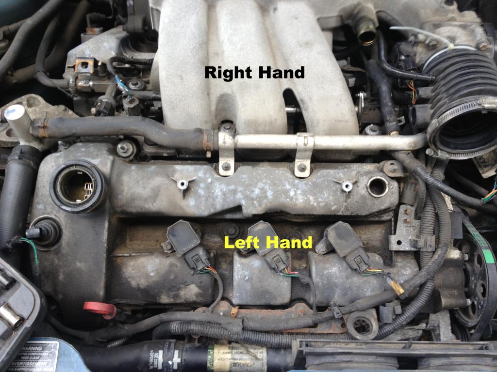

I've been consistently getting oil in my spark plug chambers, and after reading up on it appears that that my spark plug seals may have failed. There are two spark plug boss seals, one protecting each bank of spark plugs. The bank toward the rear of the car and closest to the passenger compartment is the right hand bank, the one toward the front of the car is the left hand bank.
I started with the Right hand bank, and that's what I'll post below. I'll update with the left hand bank in the near future.
To begin, you'll have to remove the intake manifold to access the right hand valve cover. It's the same process as if you were to change the spark plugs in that bank. There is a good writeup of that by rhriczko here -
https://www.jaguarforums.com/forum/x...nge-faq-48128/
Once you have the manifold off you can start removing all the electrical connections from the valve cover. Start with the ignition coils to the spark plugs, the wiring harness and the vct connector.
Next remove the engine cover retainer bracket (front passenger side of the valve cover),
and the intake manifold support bracket (rear of the valve cover).

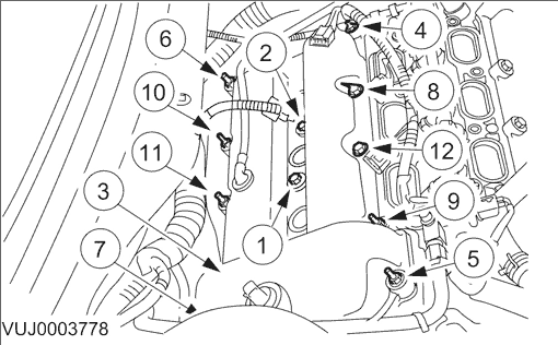

These two brackets, and a few other support brackets, are tricky. They are attached by means of an 8mm nut on each of the connection bolts.
You have to remove the 8mm nut first, before you can access the 10mm bolt that connects the valve cover. You'll need a deep socket for 8mm and 10mm to get these off.
There are a total of 12 bolts you have to loosen. 8 have the 8mm nut on top. Bolts 1 and 2 and 8 and 12 do not and can be loosened with a standard 10mm socket. Removal of each bolt is not necessary, just to loosen them up and free them from the connection from the body. I wound up removing them all only to discover this later.
Once you've loosened the bolts the valve cover comes off with a good pull. There's a little resistance around the VCT connector, but not much. When I pulled the cover off the spark plug boss stayed inside, but the valve cover seal came out with the cover.

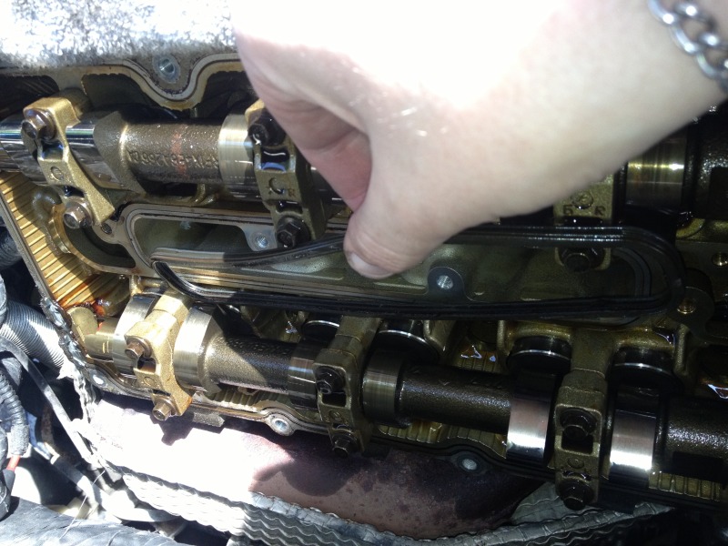

Then replace the valve cover seal, making sure to clean the area of contact and ensure there isn't any gunk there. I had to gently scrape some parts of the valve cover to remove some gasket material.
It's a tight fit, but should go in smoothly. Remember that if you buy the kit you get both a right and left hand seal, make sure you use the right one on the right side. There are some guide points that should help to ensure a proper fit. And notice that the "raised" side sticks out from the valve cover, while the "flat" side fits neatly into the channel.
I used a few bits of black gasket maker around the outside of each bolt hole.
Perma Products Company ULTRA BLACK MAX OIL RESISTANT GASKET MAKER 3.35 - 230-82180 - 230-82180 at Wares Direct
Then install the cover back on, following directions for the gasket maker, and tighten the 10mm connection bolts to 10nm. Tighten the 8mm nuts to 6nm.
This covers the right hand side valve cover. I'll post an update with the left hand side shortly.
