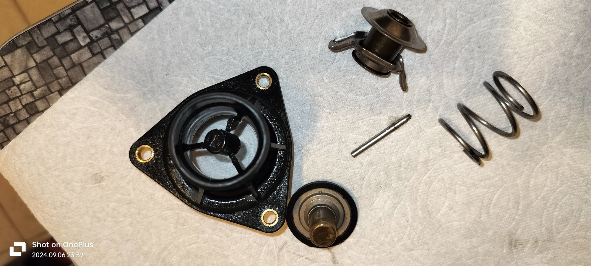

FIXED IT!!!!
Last night I decided to take out the thermostat to test it even though it had just been replaced a few months back when I had to replace the whole thermostat housing that had cracked (plastic) and it also came with a new thermostat.
Well to my surprise when I removed the 3 bolts to pull out the thermostat, it came out in pieces!! Apparently one of the 2 plastic tabs that hold the spring compressed had busted and caused it to just come apart somehow keeping it closed. Really sucks since that thermostat and its plastic housing cost over $100! for plastic.
Thank you to all who replied to this post. I'll try to post a pic.

I'm a bit late. Sorry to say this, but the first thing we do in such a case is to check the newly installed part. It can happen that these parts are installed under tension or at an angle and then they block. Or, as in your case, they simply give up the ghost after the first use. We've already had both of these happen at least twice.

Wow! That's certainly a dandy!
