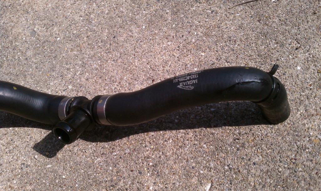

Hey,
This might not be your issue but wanted to show you that hose with the T-Fitting that had a slice in mine, where I couldn't really see it. Check out the picture I attached below. Ever since I replaced it, That pool dissappeared for me, but always under a watchful eye.
Hope you guys/gals can get this fixed up.
