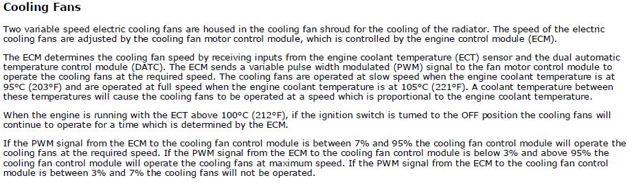

Below I have attached the cooling fan operation details. 206 would be a nice normal operating temperature. When the engine is running and the AC system is on the ECU will automatically kick in the fans to prevent overheating. AC on means automatic fan running.
If the fans are acting erratic then you probably need a new ECT engine coolant temperature sensor. The simple test would be to use a coded reader that can check engine temp. While observing that reading take an actual temp reading at the hoses and compare the results.

The above is very useful piece of information!
