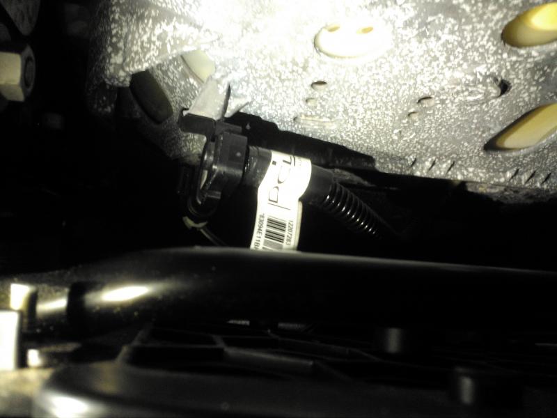

Our 2003 S-Type is experiencing the same issue. It does not matter how heavy the passenger is as I have had weight ranges from 135 to over 200lbs in the passenger seat when the Passenger Airbag inactive light turns on sporadically.
I have identified 2 parts that could be related:
XR837242 and XR841177
I have also attached a picture of what I believe to the be weight sensor. I believe it's XR837242. Does anyone know how these sensors are suppose to work? Is XR837242 a binary on/off switch or is it actually sending a resisted current to a controller?
My concern is that I replace the sensor but the triggering mechanism in the cushion still forces the new sensor to send the same resisted current. In that case, I would assume that the Jaguar dealer software has the ability to reprogram the controller to become less sensitive to passenger airbag deactivation. Anyone an expert on these sensor and how to troubleshoot without special Jag diag?

Thank you for your response billbjork and fabfive, but I am trying to correctly fix this issue. I want to make certain that my airbags and other safety functions of the car work properly when needed. If you have an adult passenger and the light is on, or decides it wants to come on at/during impact you are endangering that passenger.

The seat belt does not have any effect with regards to the passenger side occupant detection. The car still uses the sensor in the seat to determine if an adult is present or not. I'm just trying to figure out how this sensor is working and being evaluated by the SRS control module. i.e. binary or resistive.

I had a similar problem in my 00 S Type. The light on the instrument cluster would come on for a while the it would be out for a while(days). I then noticed a pattern to it. the light would blink 3 times then six times. Code indicated an open wire to the sensor. I checked under the seat and sure enough one of the two wires in the wire harness for the air bag sensor was broken. I have memory seats so when I drive the seat is much farther back than when my wife drives. I think it got stretched a little when she gets in. I ended up having to solder in an extra length of wire to prevent it from breaking again.
If its a bad ground the weather could definately have an impact on it. the bolts holding the seat in place may be corroded or a ground terminal at the other end of the wire harness might be dirty. A little investigation could save a trip to the shop.
