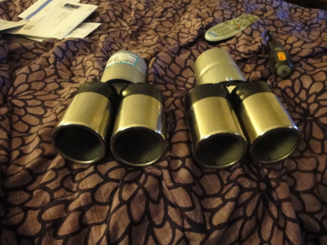

decided to do quad exhaust in the rear
heres the tips

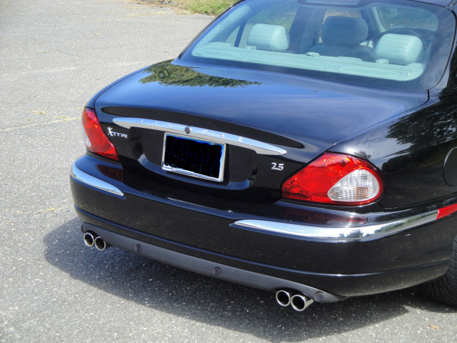

then i cut the tips of the stock muffler with a saw zaw,
then welded the new ones on
i orded them from ebay , i tried a few differant ones till i found the one i liked
cost me $60 ,i wanted to keep the muffler stock and quiet
i have a mazda rx7 which is load,so i wanted one car which was quiet
pretty simple job took about 2hours

Looks great..... but did you need to modify the lower PVC panel ? (around the quad profile)
Old Sep 2, 2012 | 02:53 PM
dennis black's Avatar
20 Year Member
Joined: May 2006
Posts: 2,058
Likes: 595
From: connecticut
no cutting it fits perfectly, you have to have the right size tips

ill look up the ebay seller for you guys

i orded these pipes a few months ago so im trying to find the seller i should have it by tomorrow ....

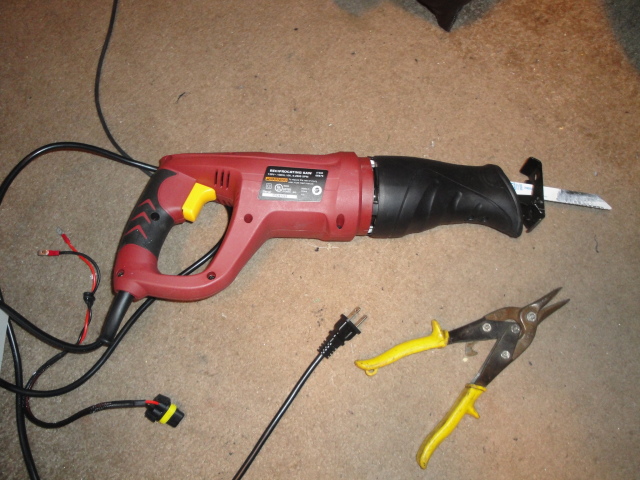

these are the tools you need

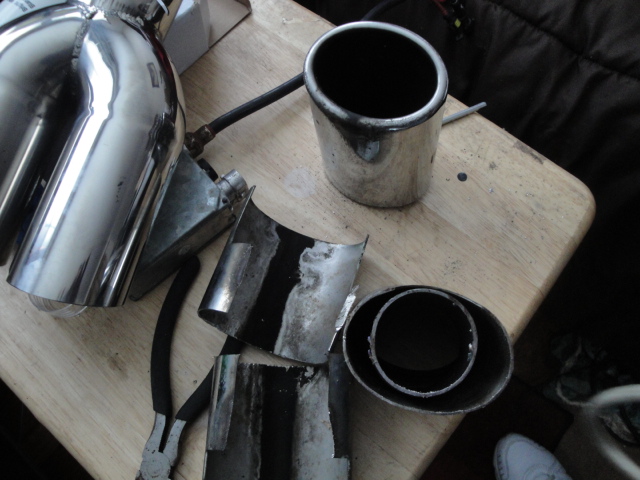

dennis...did you cut off the connecting piece from the new tips?...on the ebay listing the connector has quite an upward angle on it, in your pic the connector is a straight coupler
Old Sep 9, 2012 | 09:46 AM
20 Year Member
Joined: May 2006
Posts: 2,058
Likes: 595
From: connecticut
yes thats where the tin snips come into play,very easy to cut off i did one my neice did the other ,then i went to autozone ant put a 21/2 inch adapter on for $3 ....that was it ,look in the first pic how i atached it
