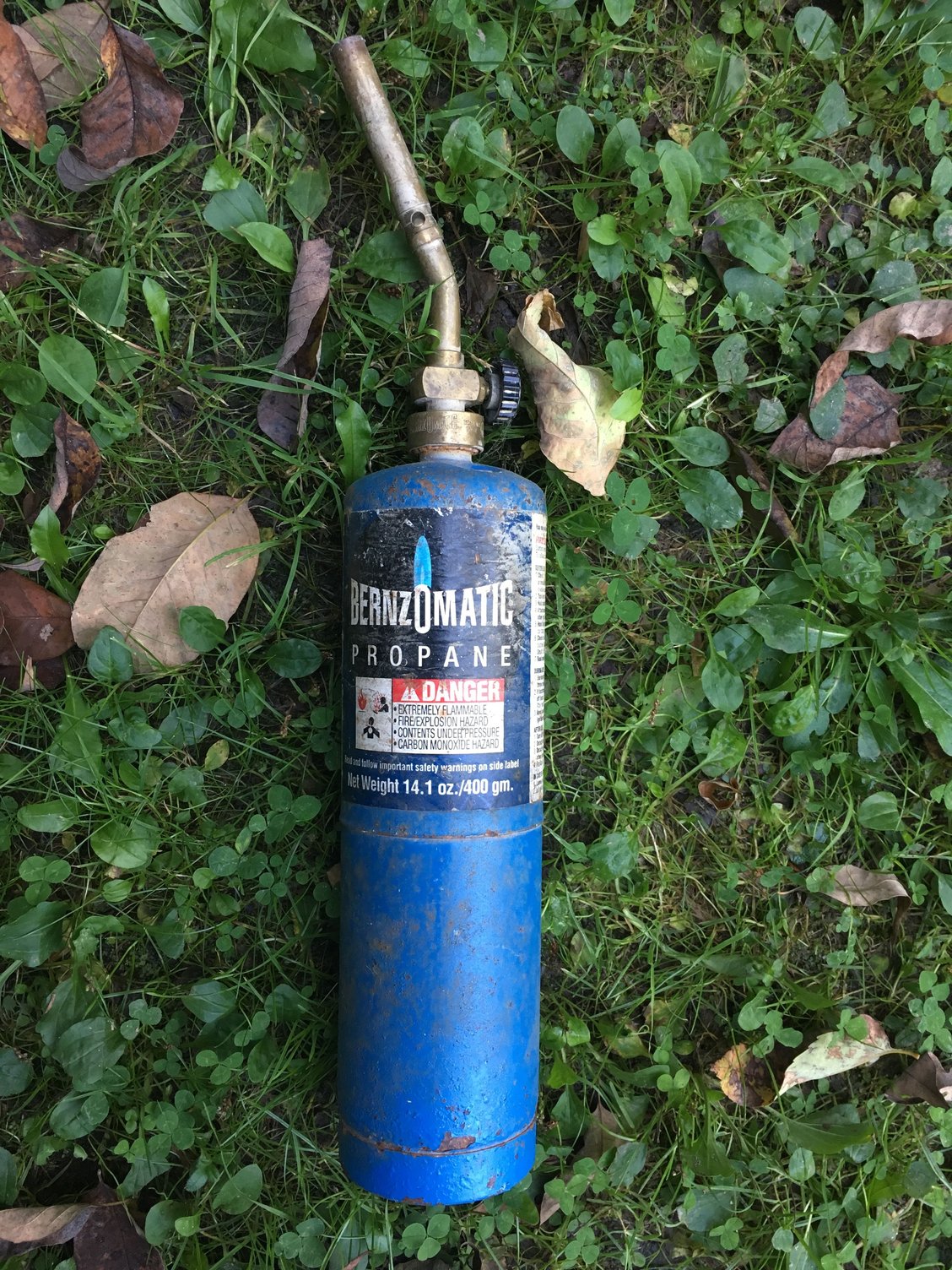

should i reattach the hub bolts and try a sledgehammer on the halfshaft with the hub puller loosly attached but with the center bolt turned tight against the halfshaft then sledgehammer the end of the pullers bolt?
this is the only heat i have...think it will help?

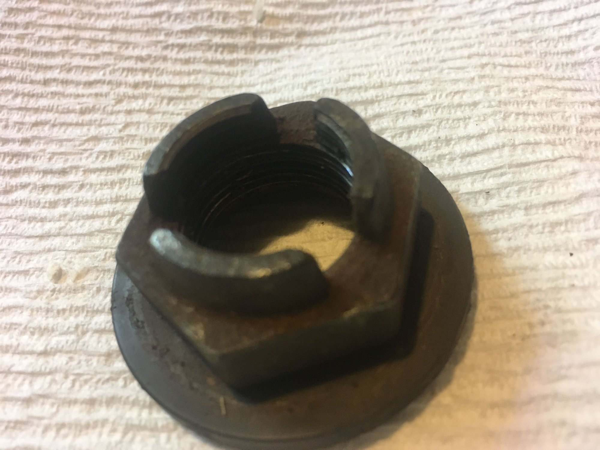

by putting the nut on the end of the shaft and using that to take the force to save the threads, wouldnt those three raised pieces on the nut just crack off?
i was using a 3lb mallet, i also have a 7lb
i tried using the puller as a "pusher" against the shaft, using the center bolt on the puller, tight up against the shaft then pounded the puller bolt with the 3lb mallet...that did nothing!

The three raised piece's need to be just flush with the end of the driveshaft ... I do feel for you dude my drive shaft took one hell of a hit to break the splines loose from the hub ...just make sure when it starts moving not to punch it back too far and damage the drive shaft CV joint.
