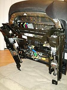

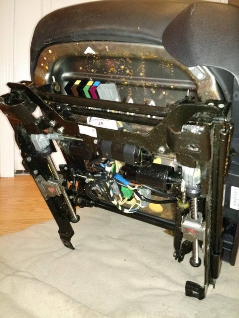

I removed the front driver seat, in an attempt to get my heated seat back.
But I don't see the heated seat module?? It's located in the front on the passenger side, but I don't see it here.
Old Oct 12, 2014 | 09:24 PM
Drak's Avatar
Joined: Jun 2014
Posts: 6
From: MI
I can't seem to edit my post, so sorry for the bump.
But both seats do not have a "heated seat module". But the passenger side 100% works, and there's wires running under the seat. Instead both seats have all the wires running to the seat control module. (The box with the external controls on it)
So, I don't get it. The X-Type wiring diagram always (for all years) shows a "heated seat control module". How come mine is incorporated into this one unit?
