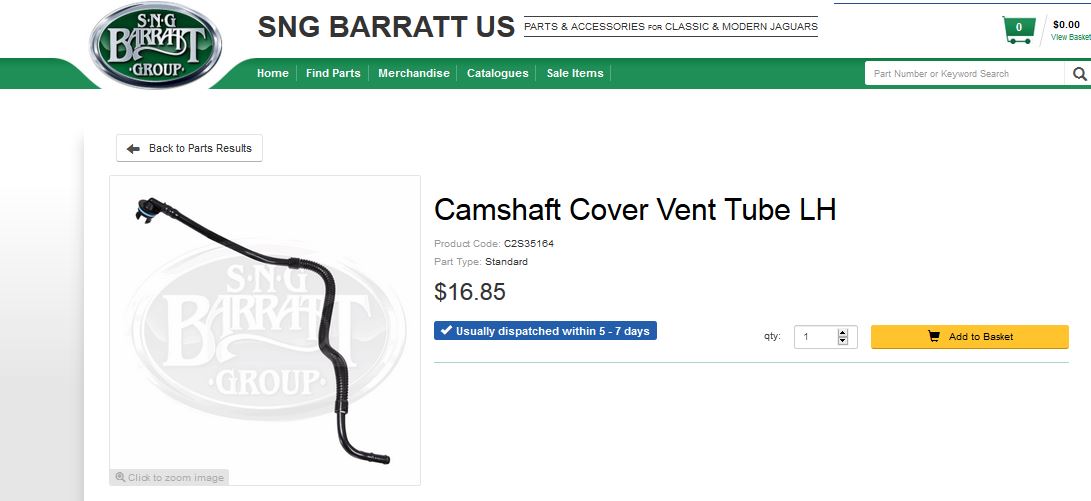

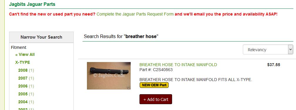

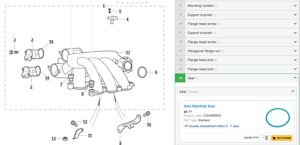

Does anyone have a photo of the "breather hose below the inlet manifold" referred to by NBCAT above, possibly also the "IMT o-rings on the upper inlet manifold"?

The breather hose is in 2 places. Rear camshaft cover breather, and front camshaft cover PCV breather hose. Attached are pictures. Piece 16 is the IMT O-rings
