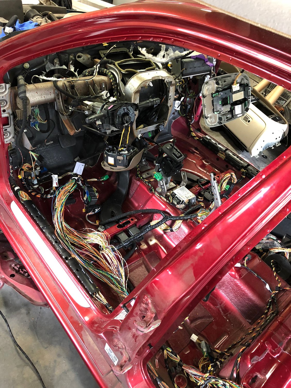

I have moved over the cabin harness which is pretty much 80% of the interior wires. I am going to swap over the instrument/stereo harness tomorrow. Should I move the can bus unit over to the other car as well or would that cause problems? The parts car has the stereo with amp and extra speakers as well as parking sensors (which I don't intend on using) so I thought it might be best to move everything over so that the computer doesn't even know it is in another cars. My only concern is if the VIN is stored in there because of the OBD plug is part of the dash harness.

all of the modules in the car have the original vin number programed into them, you can move them over and they will work but report the wrong vin when interrogated by computer
the speedo+engine ecu form part of the security system and would need to be reprogrammed to the key transponder (not the 4 button fob)
if you have access to the JLR software then nothing is a problem.

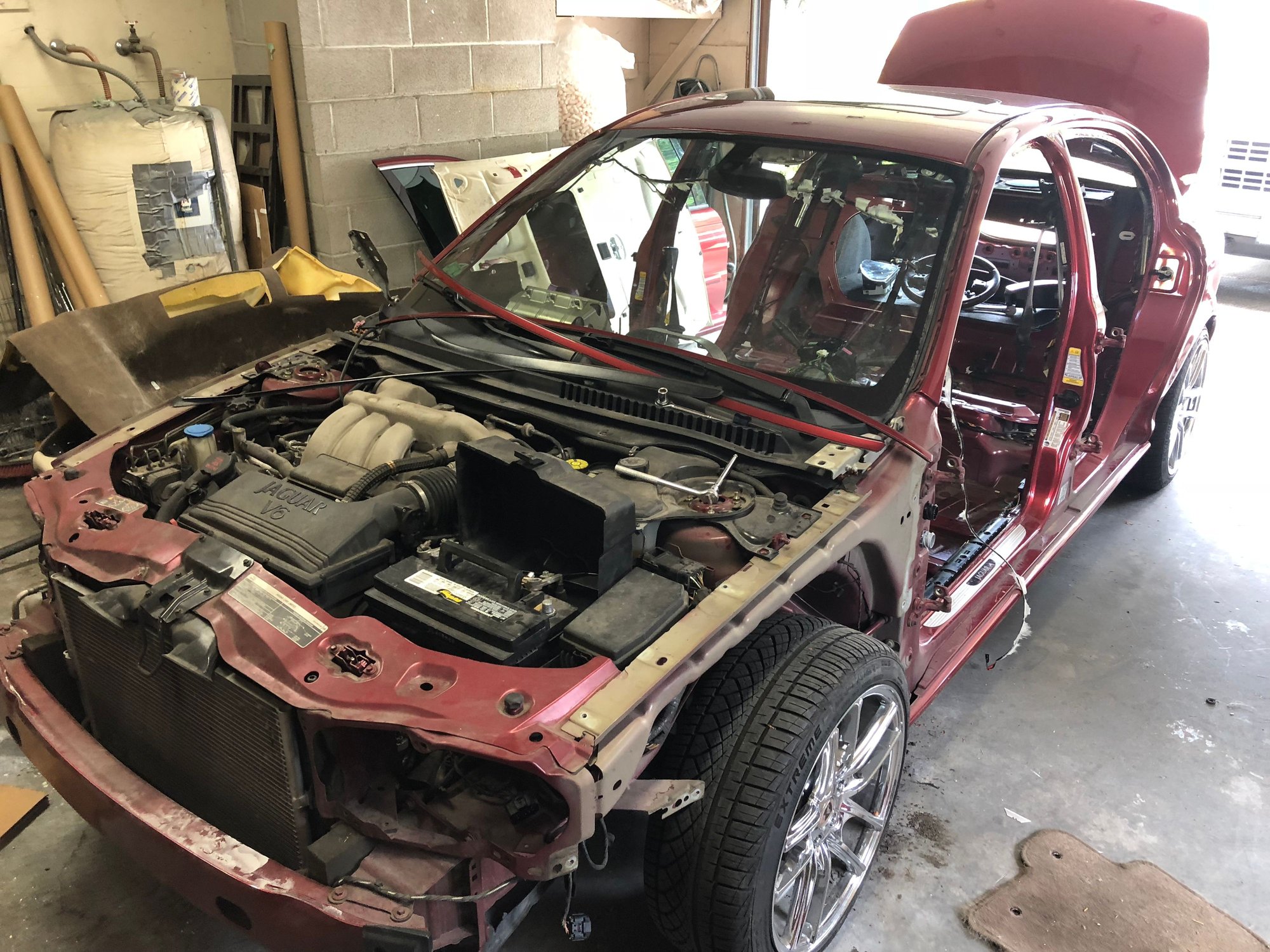

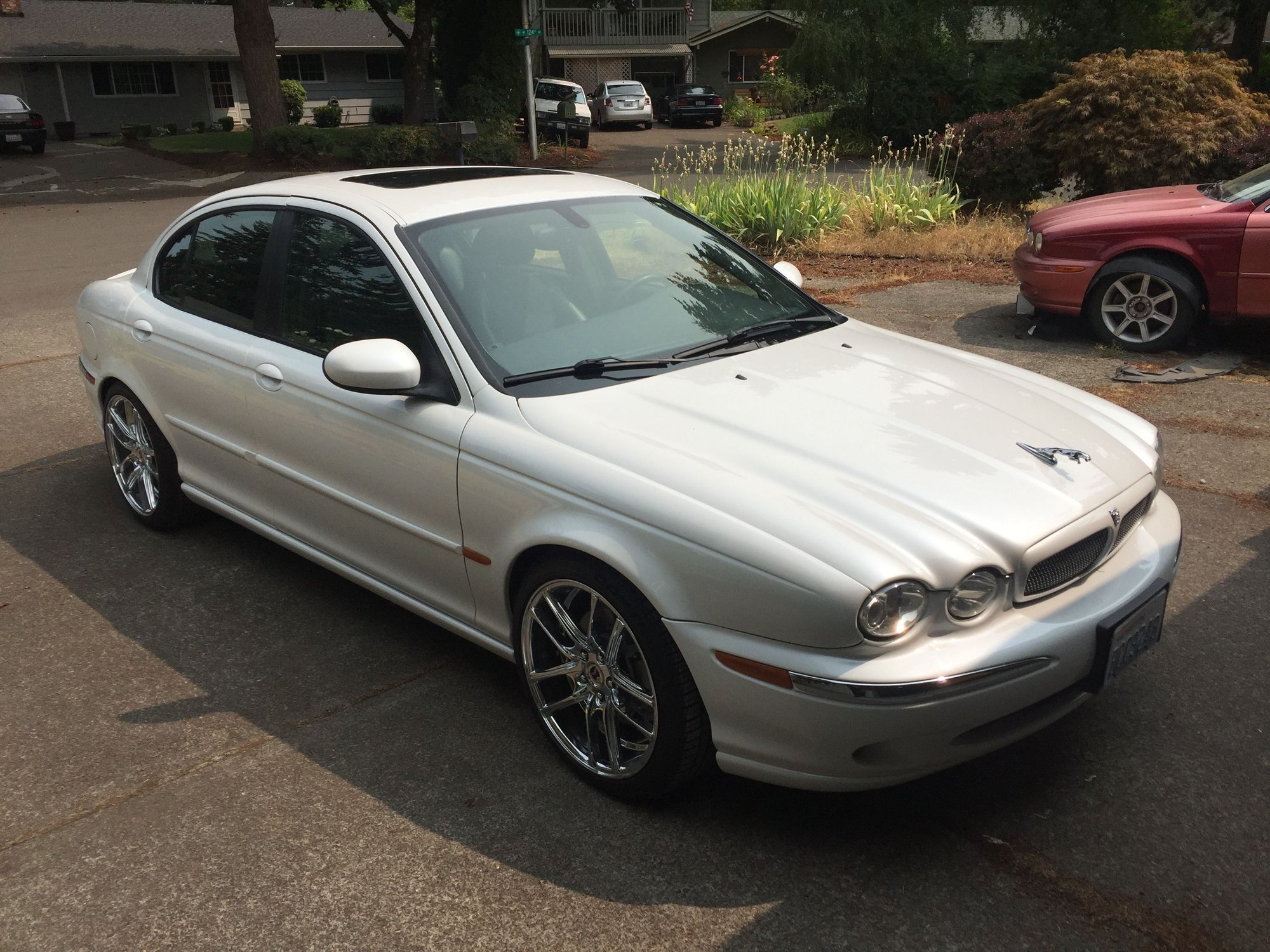

Everything is now complete. The options I added from the parts car to my car were the heated and memory seats, Alpine stereo with amp, homelink, carbon/alcantara interior and rear parking sensors which I am not using because I think they look terrible on the back bumper. All the wiring harness is moved over and now problems whatsoever. No warning lights or anything. This was an easy project but took a while as well as a full color change on the car. Why I did it, I don’t know but it sure looks good.

according tp the bumpers, neither car is the sport option

Thanks. The parts car is a sport but the front lip spoiler was half missing so I removed it before putting the bumper on my car. I don’t like the the parking sensors so I wasn’t going to use the rear bumper. This left just the side skirts and rear spoiler. I held the side skirts up to my car but without the front and rear bumper lips, they just looked weird. The only thing I used that was the Sport parts is the trunk spoiler.

Now you need to "chrisfix" your Jaguar X as he did to make money. He left some things on too that were worth some $ (i.e. gas tank, fuel pump, sending unit, etc.)

I thought the sport models had color matched trim on both bumpers and not chrome?

And? They both have chrome, yes? Spoiler is not sport specific, just an option.
