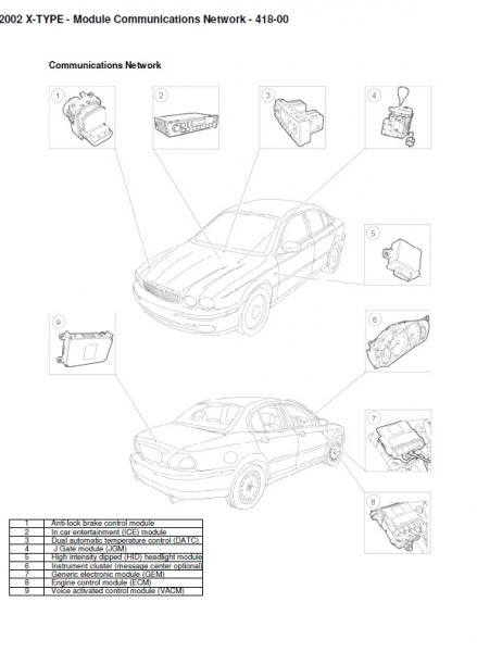

Originally Posted by lancervi50
........... How does that work, if you have the climate control panel removed the car won't work?
It's one of the components in the Communications Network. Ignition ON validates the modules are present, correctly coded to the vehicle and operational:
When the Network is interrupted, starting is inhibited for safety and security reasons.
