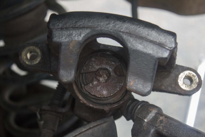

... I decided to change the rear pads because they were *very* thin. Long story short - frozen drivers rear caliper so ... car is a three wheeler at the moment - new (both) rear calipers ordered locally - hopefully they'll get delivered tomorrow while I'm working from home)
<sigh>

Got one of my rears done today! That piston is just a JOY to turn back in, isn't it! Looks like the last mechanic to change the brakes on this car only changed the pads, and never screwed then back, so my rotors were nice and crisp on the outside, and worn on the back.
I'll bet some new, clean calipers make the rest of your job go easier!
