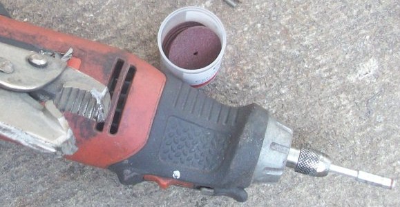

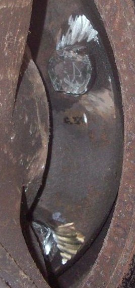

I used drimel to cut flats on stud heads, so vise-grips could hold it. I had to modify vise-grips to hold stud head.
But this was not the best way.
The easiest solution is to weld stud heads to hub. It will take just a small weld spot to hold stud head.
Attached Thumbnails Solution for turning wheel studs.-stud-004.jpg   Solution for turning wheel studs.-stud-006.jpg   Solution for turning wheel studs.-stud-008.jpg
