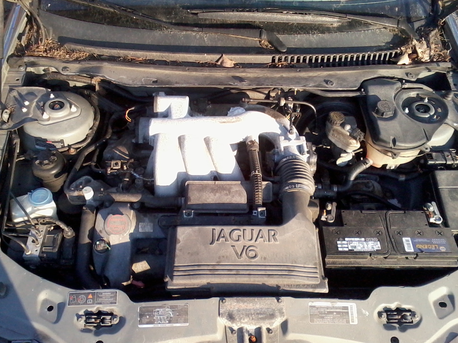

Now shopping, and have seen a 2003 X-Type, seller not present. I am unfamiliar with X-Type, but imagine that something would jump out at you folks right away, as something seems to have already jumped out from beneath the bonnet, passenger side.
First 5 pix, A-E.

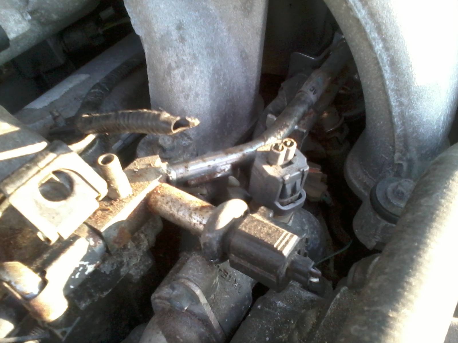

Also, at top center, between engine and firewall, clearly wires are snipped.
Next 3 pix, F-H.

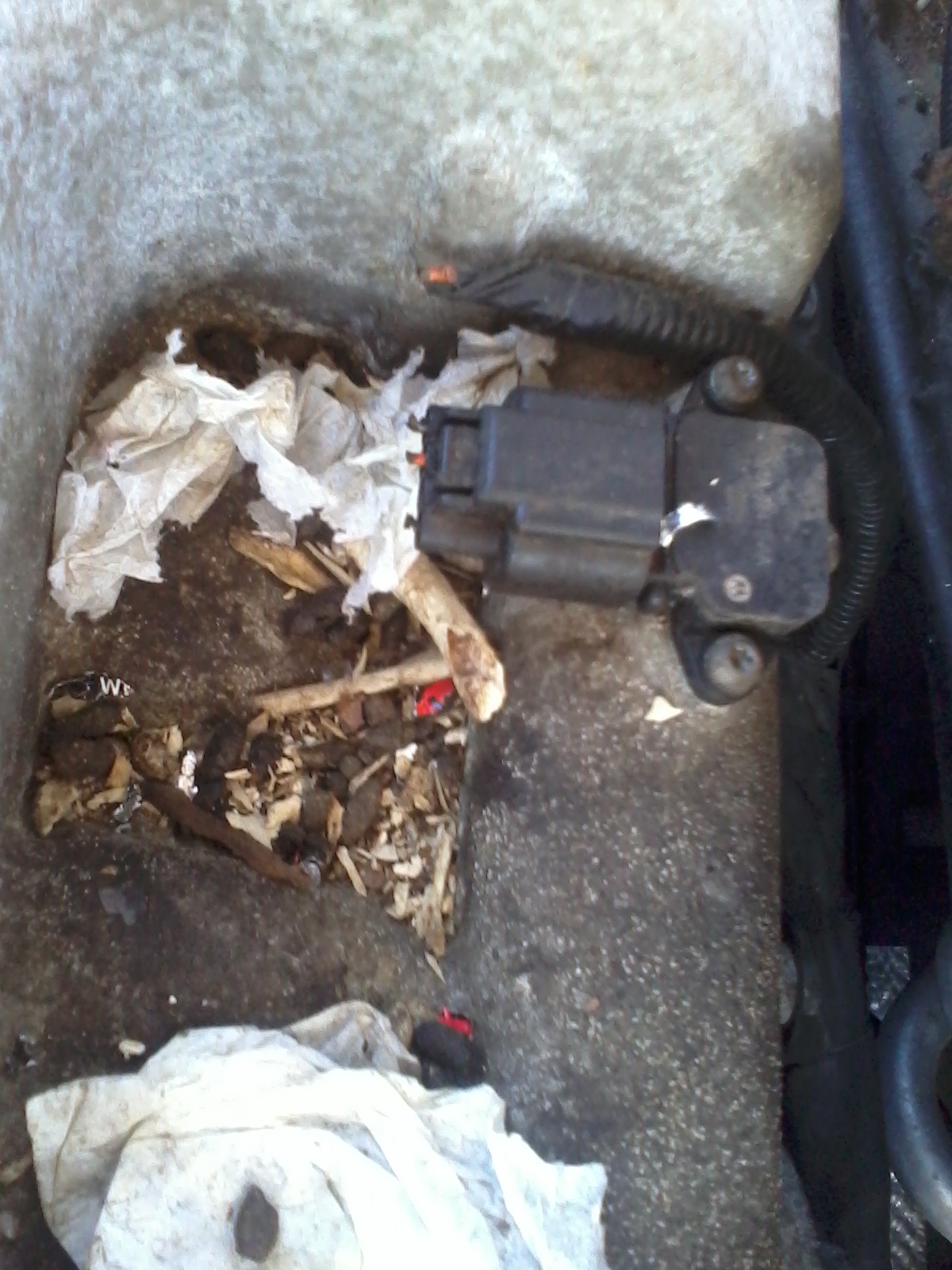

Three substantial, threaded, mounting points are visible.
I hope to identify what's missing so that I can get a sense of what's needed. Remainder of engine and vehicle in notably good condition, to the point of suspicion. Why would missing material be thus removed? Simply theft? Why these components, necessarily?

Picture 1 = Is the engine cover. Here is a link on ebay to show you what it looks like. http://www.ebay.com/itm/2003-Jaguar-X-Type-Upper-Engine-Cover-Black-OEM-LKQ-/361935975417?hash=item544510b3f9:g:-AIAAOSwWxNY1RGP&vxp=mtr
Picture 3 is a vacuum line. If you download the free catalog from SNGBARRAT a forum sponsor you will find it on page 40 to see what it looks like.

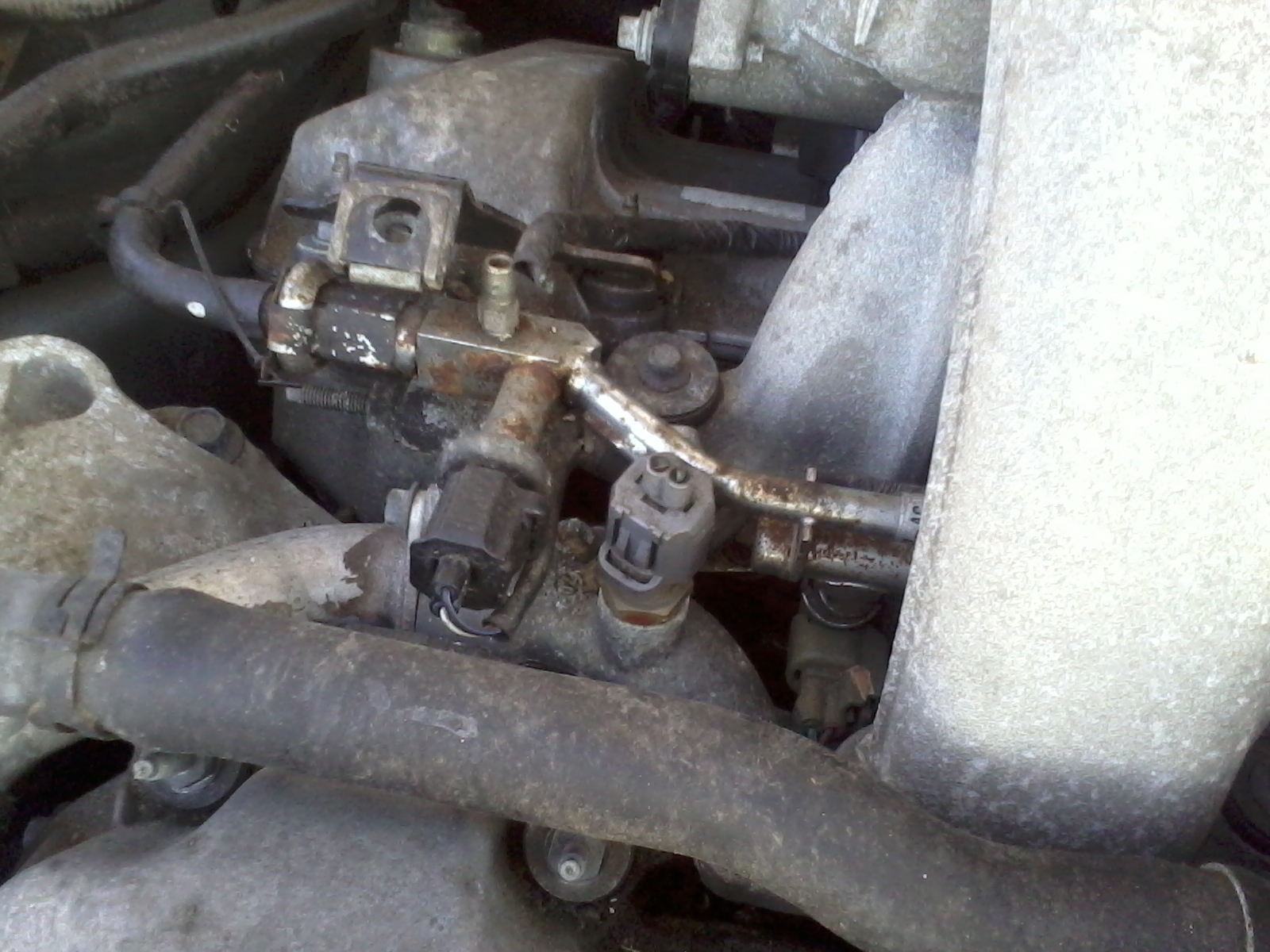

Picture 4 is the water temperature sensor.

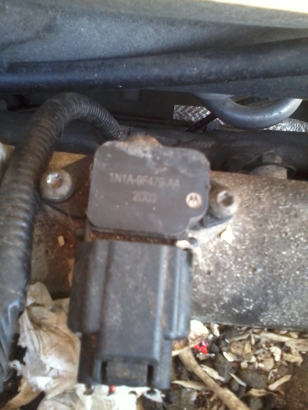

Picture 6 is difficult to identify since I can't see where on the engine it is located. It would also be helpful if the numbers on it could be posted. Then a google search might reveal it purpose.

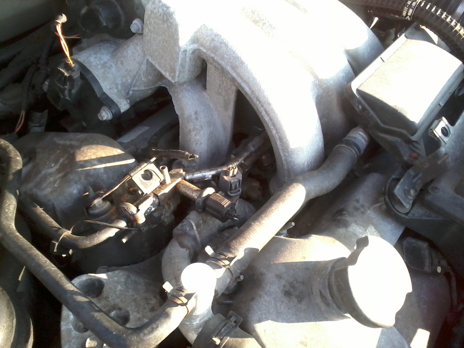

Hard to tell, but in those last three pictures it looks like something made a nest in there. You would have thought that the person selling it would at least clean up the engine bay a little. Ask if it was sitting for quite a while. I have a feeling the person had some kind of issue that they couldn't fix and let it sit. If that's the case, unless you are prepared to put a lot of time into it or it is basically free keep looking. There are plenty of others out there that run.

With this being said, the one plug (pictures 6 and 7) appears to be the manifold pressure sensor. The wires are not too far away, but you are going to need to reattach the wires. This is where things will get interesting for you. You can dismantle the plug and extend the wiring to make it all work again, but if you mess up the pins in the plug, it is going to be difficult to find the new pins and/or a new plug. There are a few sites on the internet that you can get the plugs, but you need to give them a lot of specific information as a lot of the plugs are keyed so they can only go on in one place.
In picture 4, that line I believe is for the fuel rail pressure regulator. It helps to raise/lower the fuel rail pressure to keep it 50 psi above the intake pressure. Replacing that hose should not be too bad of a job.
