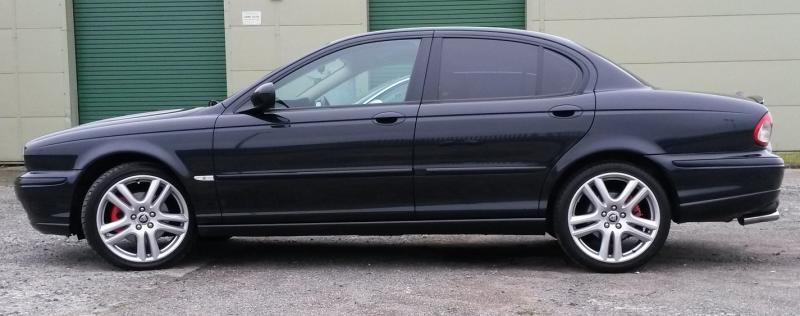

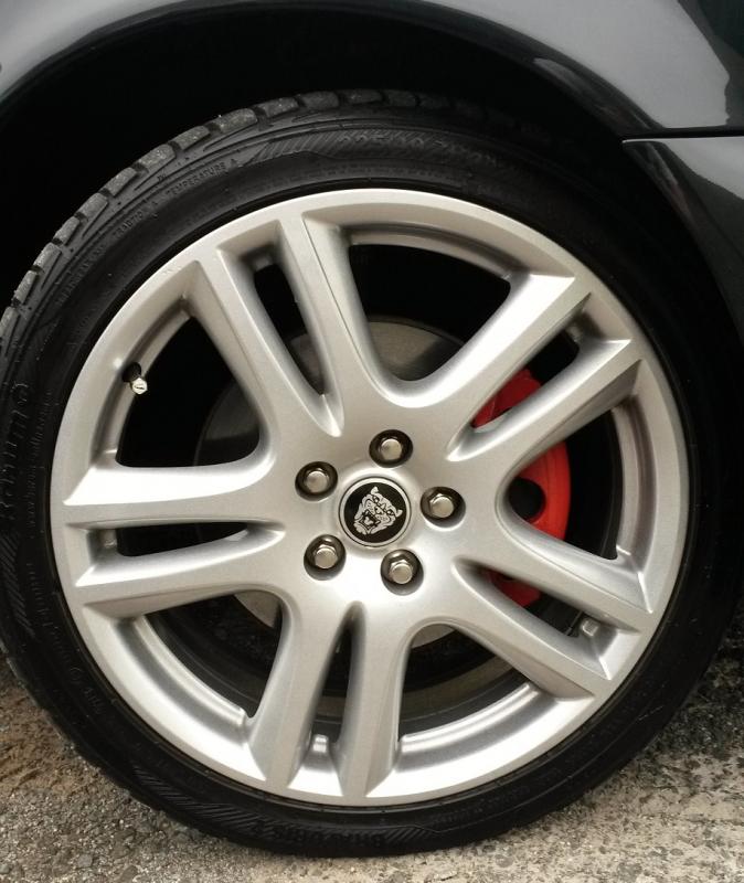

Well a pleasant few hours were spent tonight with the X type up in the air and wheels off.
The hubs were refinished in silver to look stock and he chose a nice red for the calipers. Thw wheels were cleaned inside n out at the same time and tyre dressing applied.
Have to say it suits the car!!
Thats her all done now, barring the rear bootlid plinth mod ( painted black to match body colour with JAGAUR drilled out and LED backlighting.
I think he's looking forward to getting her shined up for the meet on the 29th

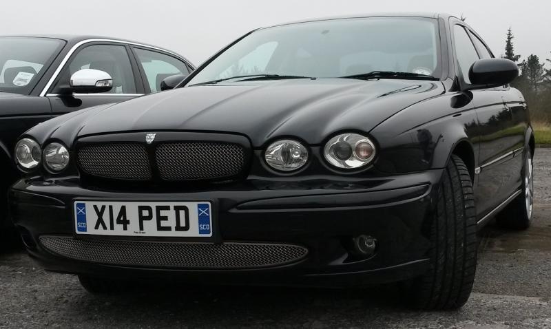

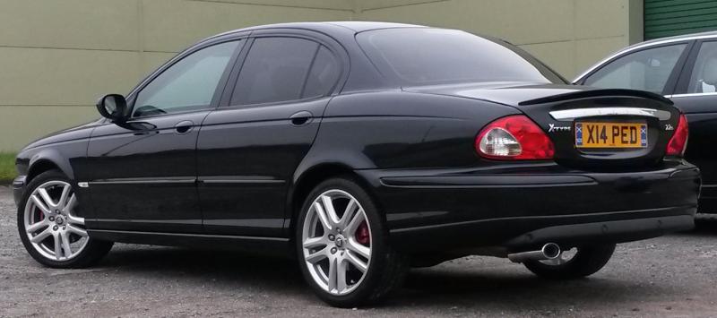

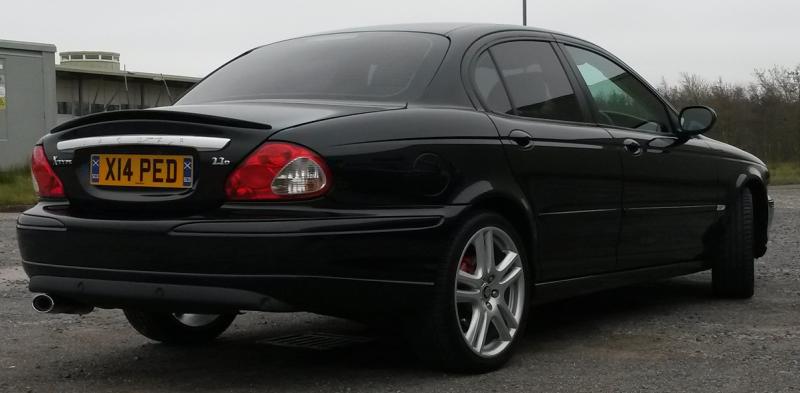

Ok, so as posted earlier, hubs n calipers painted and today, rear number plate, which was a little squint, removed and replaced centre and level ( not in pics shown though )
The red looks great, but perhaps a 2nd coat required, this to be done in the next month or two
All mods now completed except rear bootlid plinth which is being drilled as we speak......another few hours of work on that though, then to be primed / painted and installed c/w led's that need to be installed........watch this sapce

Originally Posted by 04xtype04
Did you take the brake pads out to paint the calipers? I was thinking of doing that for fun but I didn't know if I should remove the pads
Hi there, no, the brake pads were not removed.
Wheels off and cleaned inside n out thoroughly, then the hub part which can be seen ( which is usually dirty / rusty painted a stock silver colour )
The calipers painted slowly and carefully in RED
I'd say allow around 45 mins - 1 hour for each wheel for a really great clean looking finish.
As an aside, its a great opportuntiy to wash / clean the wheel well liners and then coat them in a tyre black type product to complete the clean look

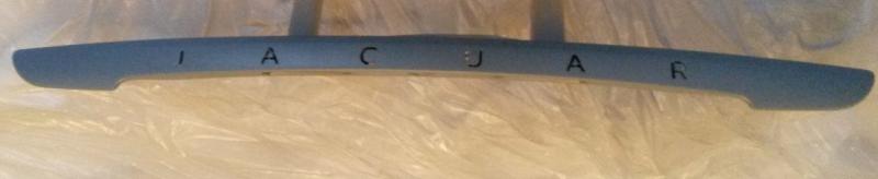

Ok so started again tonight......
After many hours of drilling and smoothing out the word J A G U A R I'm left with this in the basic unprimed / unpainted version.....
Bare unprimed / unpainted bootlid plinth
I gave it a little sand over with 800 grit to rough it up and give the primer a key, after 2 coats I was left with this
2 coats of primer....
Then over a few hours it was 3 coats of Black paint PEF Midnight to match the body colour and 2 coats of clear lacquer , which gave me this...
3 coats of paint and 2 coats of lacquer
Sorry for the crappy phone pics but you get the general idea.......
The end result should look something like this, except that the bootlid plinth will be body coloured and not chrome
I'm going with white LED's and am sure everything will be fine, however, depending on any issues I can easily revert them to red if required.
I have the leds all ready good to go......I will look at adding a small amount of waterproof clear silicone to waterproof them and then look to get it fitted and wired in to the lights.

Now he's sweating the placement of the LED's.......too close to the letter and it will give out a blurry light effect, too far away and it will be a shadowy light effect.....lol
I'm sure we'll figure it out....
As stated the other conundrum is whether to go with a waterrproof clear silcone sealant to "fill" the letters to avoid water ingress, or try to find some other method......
Hope to have a final update in the near future and put this to bed...
