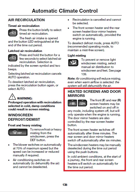

Here is the relevant extract from the Owner's Handbook for the 2006MY X-Type describing the operation:

I'm in the states; my front screen turns on automatically for three minutes at anything below about 5ēC of so; my rear window and mirrors are run by the rear switch.
My front defrost switch turns on everything, but again, the windscreen electrics turn off after three minutes.
Actually, now that I've looked at it, I DO have both. the front def button turns on the mirrors, the windscreen, the air defroster, and the rear defroster.
Front heat goes off at three minutes, rear stays on for a while.
Generally, I leave the system on auto, and it pretty much handles it on its own. Once in a while, I'll need to turn on the rear defrost manually.
