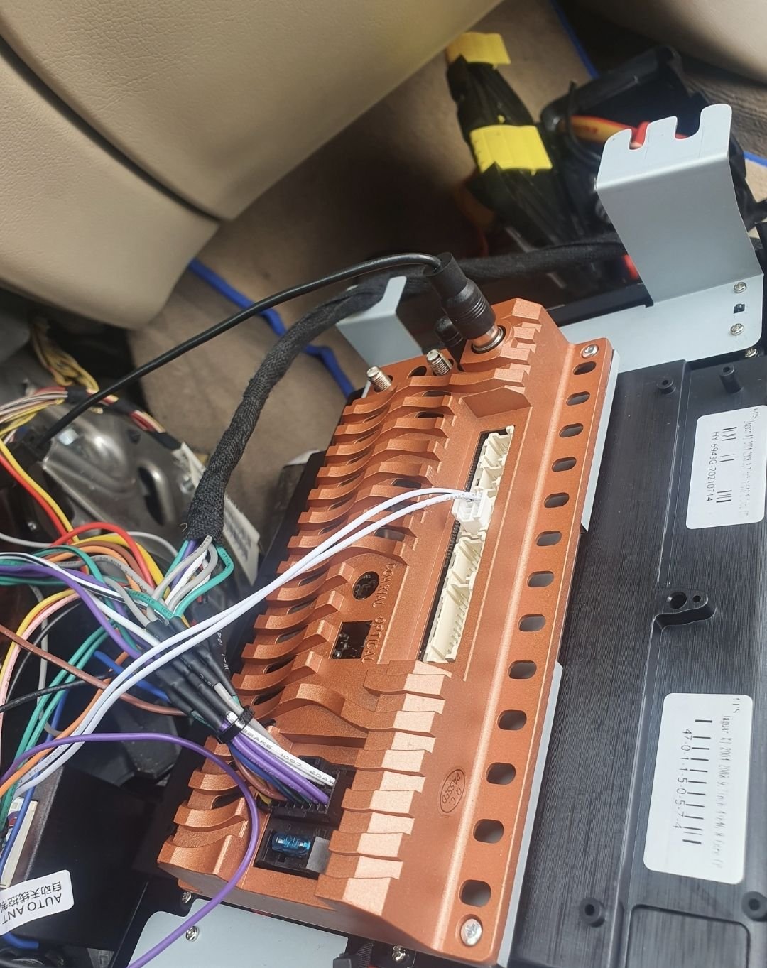

Testing this unit

well they got back to me and rolled out a new unit that fits perfect , so they want me to test that also

part--2
fitting the screen

part 3 Tesla style radio install

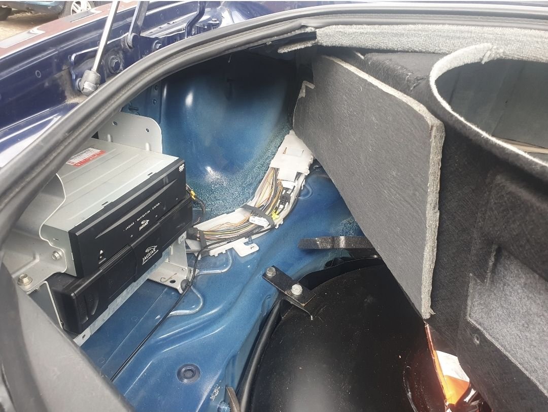

I watched all your YouTube vids and love them! I have a 2005 x-type Vanden Plas with the premium sound system (like yours?). A few questions:
  1. Does this unit work with the premium sound system? I know I will lose the nav DVD and CD players in the stack and in the trunk.
  2. Will it work with the OEM amplifier?
  3. Will I need to run a new harness from the back of the car to the front?
  4. Do you know if they are shipping the x-type specific unit instead of the s-type unit you used?

This works perfect with premium sound system with amplifier
you will not need a harness everything comes in the kit
they did not finalize the x-type specific unit ,its for the xj you will have to still trim it
for those who don't have the premium amp , the the plug for that i think is back there ,if not you will have to get a headunit adapter for the speakers and then your good
you just need the speaker connections easy job, also ill do a video for the guys with the no amp feature

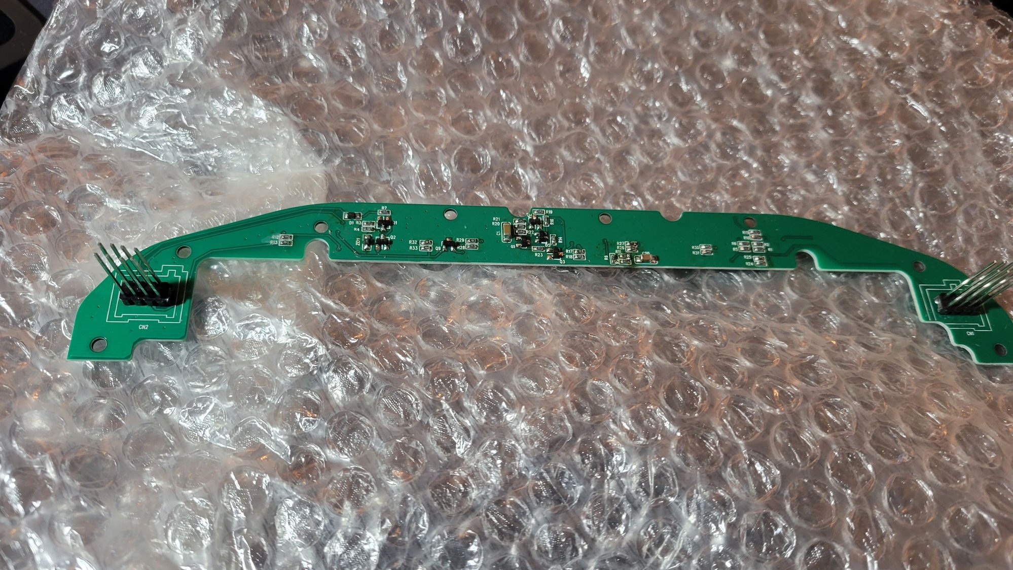

Default Why doesn't the top buttons (Seat heating, door lock, etc.) work?
Hi, I bought this multimedia for my s - type car, but the top buttons don't work. Maybe you know why?

where did you purchase it, also im sure you have but did you connect the small plugs in the top

Dear Dennis,
I bought aliexpress. I paid 900 euros. Everything works fine, only the top buttons don't work because there are no soldered contacts 😂 DID YOU KNOW WHERE TO BUY SUCH CONTACTS?

Yes a few subscribers were complaining about the Aliexpress units , heres a pic what it should look like, and tell them if they can get one for you, if they wont ill try and get you one

Not sure you can't buy this board separately?
