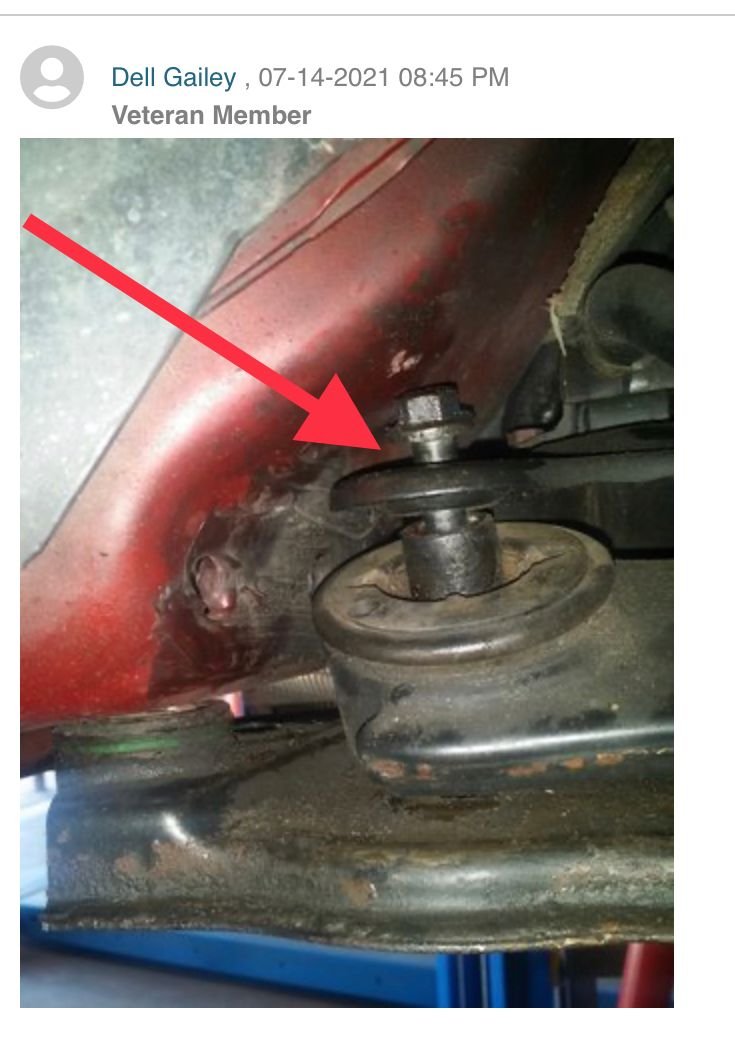

Always reinstall this one upside down to OEM install. Bolt bottom up and nut on top. That way you NEVER have to drop the subframe again.
they just got new bolts and cut the existing bolts with a rotary tool.
It all went well, the only thing we had a hard time with was the front sway bar bushings and the fact I bought two right front lower control arms.

Originally Posted by dh53
I almost replied with "I did the lower control arms, they are easy" and then I realized I did control arms when the front subframe was removed due to needing a rear catalytic converter. That subframe is NOT easy.
surprisingly, cutting the bolts made the job a LOT easier for my mechanic.

No, the bolt to the control arm was cut in half. It got to the point it’s at in Dells photo and cut of from there:

Ahh, yes, I see now what you mean. I did put my control arm bolts in from the bottom so they can come out without cutting them off if there is a next time. Dell's picture must have triggered some PTSD from laying on the cold concrete working those bolts. I was stupid to start that job in February without a garage.
