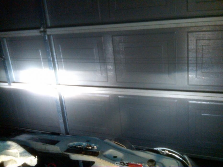

So i installed a HID kit,i hooked everything up like it said...and my passenger side is ALOT more dim than the driver side....anyone have this problem?
The lights looks sweeet from what i can side..minus one being dim????

Monchie, look at the light coming out of the headlight on the passenger side. Is it a lot more yellow or a different color than what is coming out of the driver's side? Also, if possible, swap the ballasts between the two sides. It is possible that you have a bad ballast.
Based on the shape of the image on the wall, it appears you have the bulb in the correct location (ie, focal point of the headlight).
By chance, did you touch the glass bulb on the passenger side with your bare fingers? As silly as it may sound, the oils from your fingers can affect the light output.
I would also do a quick check of the wiring just to make sure that it is all good. But, I really doubt the wiring is an issue because this normally results in a flashing of the HID or a yellowing of the light.

I could have touched the bulb,I didn't take the bumper off to install and the passenger side was pretty tough.Both lights have the same light hue,they are 4300k so a bright white with a hint of blue...ill try and switch ballasts and see if I get the same outcome

Might be a bad ballast (or bulb). Swap the ballasts and bulbs individually with the other side to narrow down the issues.

Yeah i need to just go ahead and take it off,i just swapped ballasts and still the pass. side is dim.

Thanks everyone for your help,i decided to take the bulbs out and inspect them really good,i found alot of smudges on the pass. side (go figure) cleaned it up and popped everthing back in...low and behold they are now somewhat the same brightness (definatly good enough)
