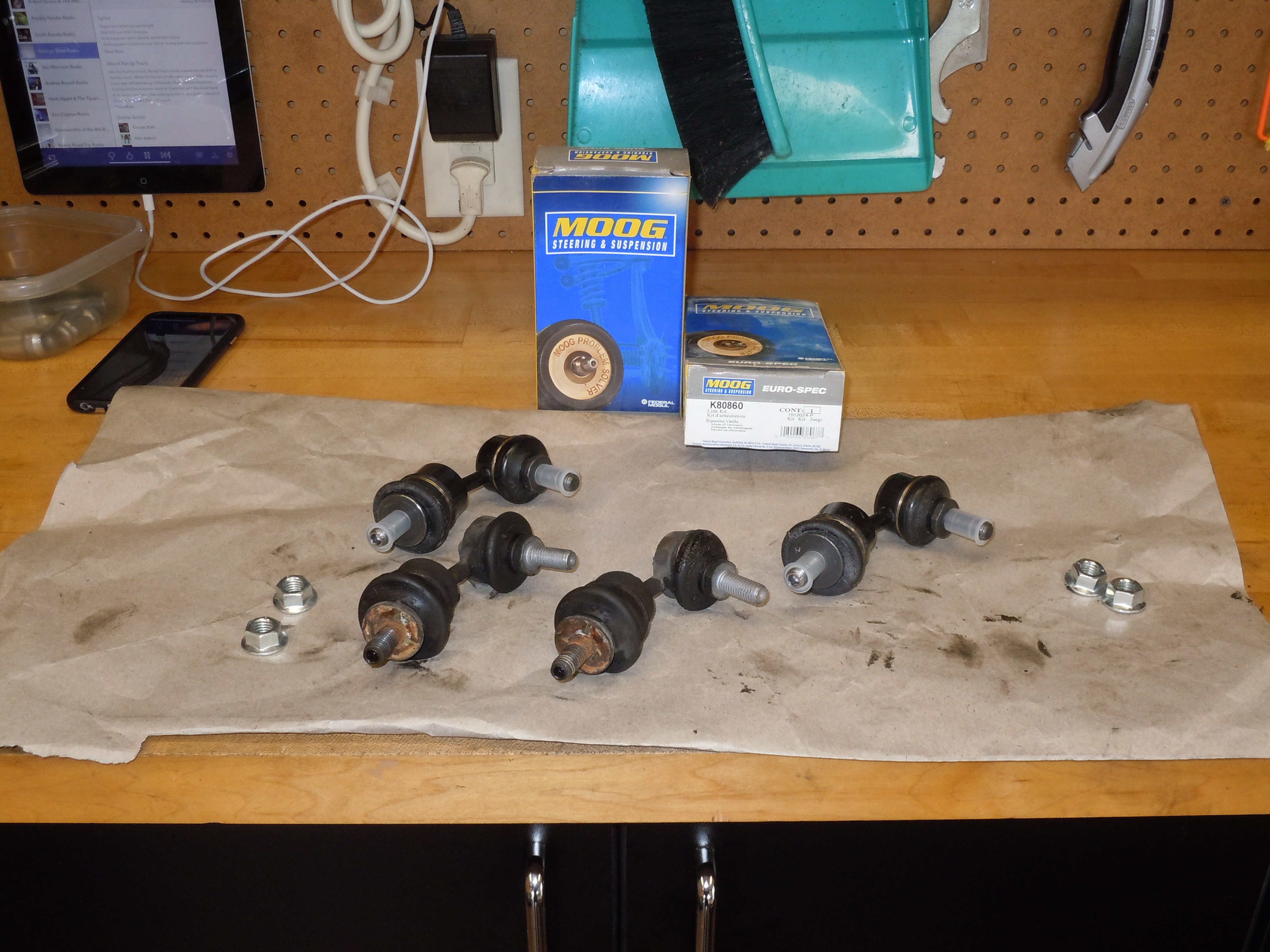

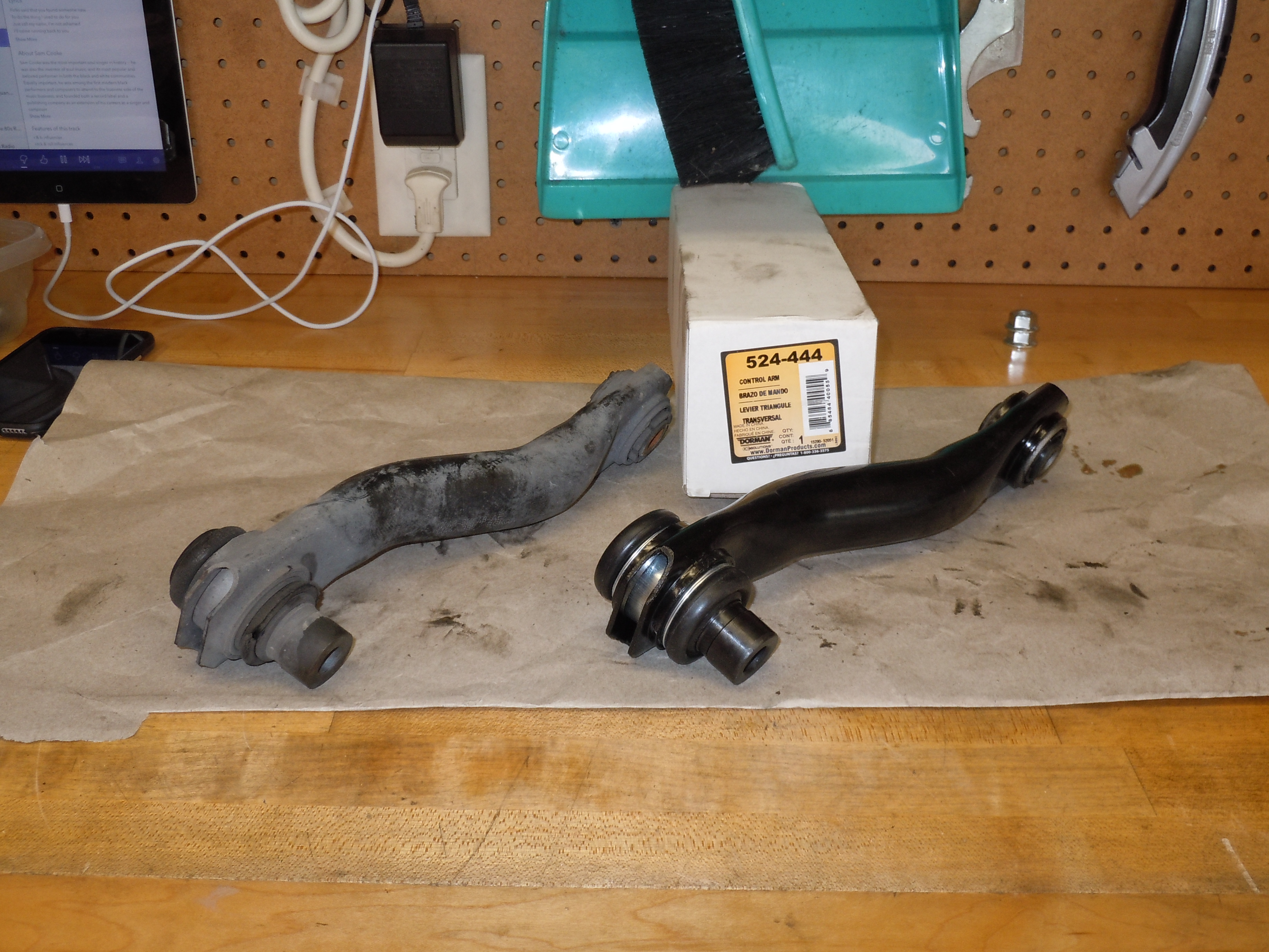

My recently-acquired 2004 with 105k miles had some clunks from rear. After a look underneath I decided to replace the rear lower control arms and sway bar links. Not interested in paying for OE parts so went with aftermarket from RockAuto (a great supplier by the way). Got both sets for $97 including shipping. The sway bar links are Moog, made in Germany. Lower control arms are Dorman, made in China. Put the back end of car up on stands for the work and did the sway bar first, which was fairly easy. You'll need a 5mm Allen key or socket plus an E8 torx socket for the bushing caps. Different story for the control arms; the 15mm bolts holding the lower control arms are really tight. Not enough room for an impact gun so I had to work them out by combination of breaker bar, wrench and ratchet. The technique of hooking two wrenches together gave me the leverage to get that one bolt that really fought. For reassembly I jacked the hub up to ride height before tightening the control arm bolts. On examining the removed parts, the lower control arms were causing the clunking noise, specifically the end with the large metal barrel. Sway bar links were still fairly tight, but all of the rubber boots were shot.
