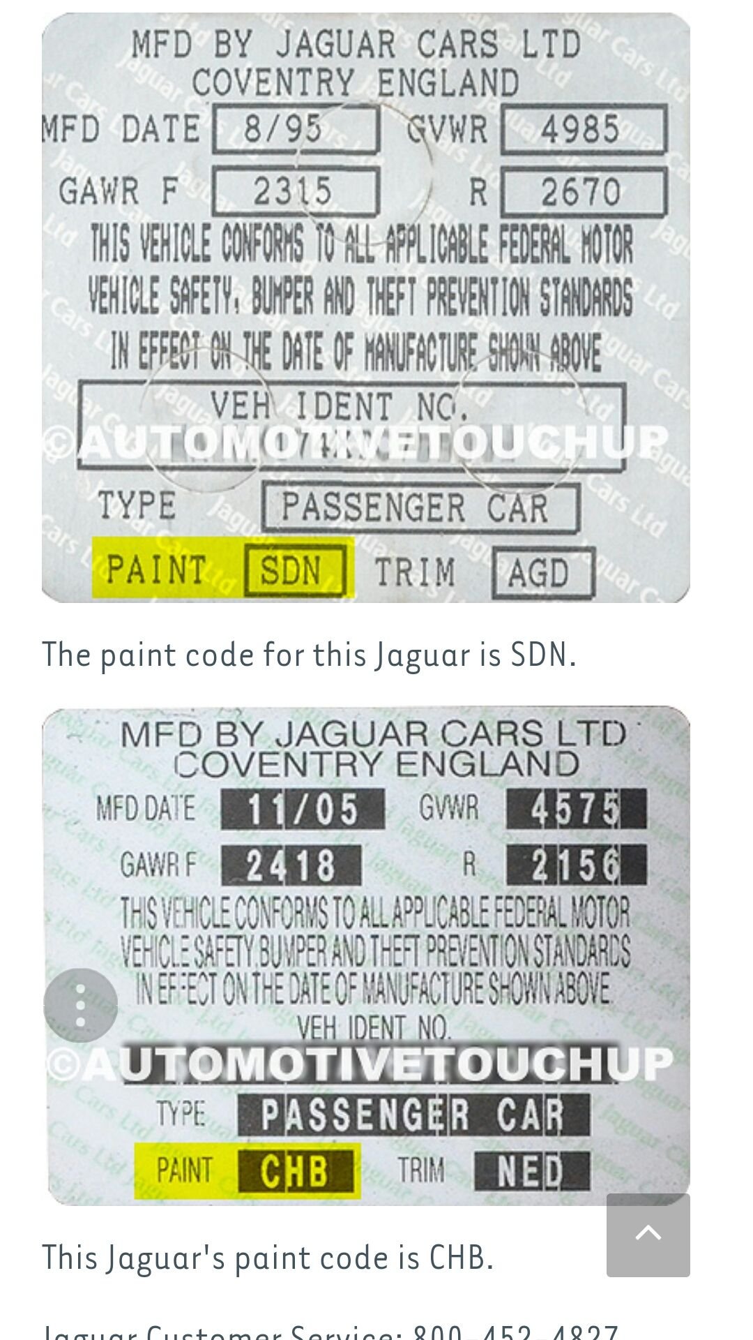

Btw, your month/year of manufacture, paint code, interior color are inside the (LHD) driver's door. It looks like this =
