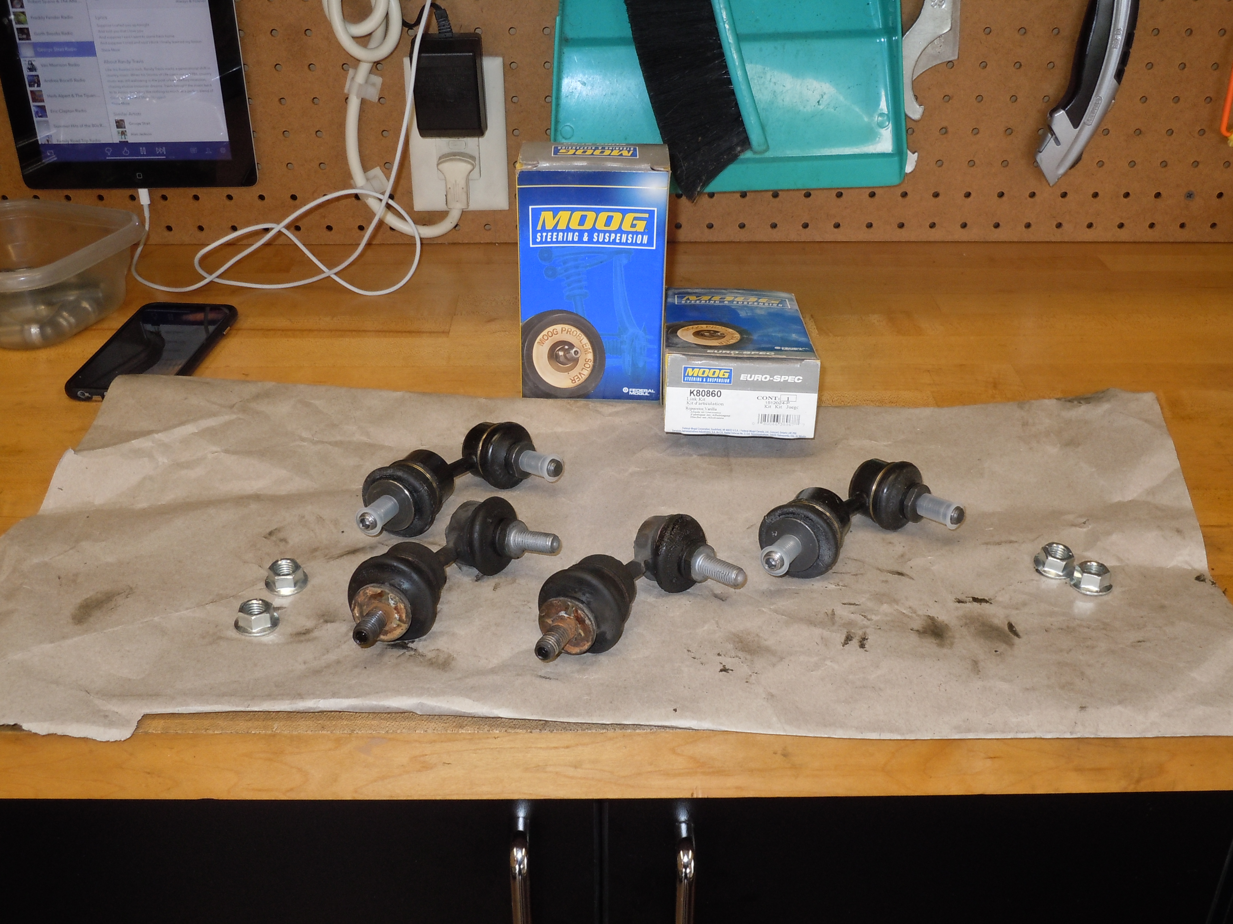

When I got my car last May I noticed some "junk in the trunk" noise that needed looking at, especially from right rear. I found that the bushings in the forward lower control arms were shot. I ordered Dorman replacements from Rock Auto, and ended up doing sway bar links, then later on some Bilstein shocks. By the way, the Moog sway bar links are not good quality, even though they were made in Germany; one came apart not two months after I put it in, and there's plenty of others on the forum with the same complaint. I replaced the bad one with a Lemforder part that's much better quality. For your car, I'd say put it up, remove the wheels and have a look. Replacement is pretty straightforward, but the M12 attachment bolts are a bear to get out. Here's a video I've seen that also may help:
Attached Thumbnails X Type Engine Oil Leaks plus Noise-r-lower-fwd-arms.jpg   X Type Engine Oil Leaks plus Noise-r-lower-fwd-arms1.jpg   X Type Engine Oil Leaks plus Noise-r-sway-links.jpg
