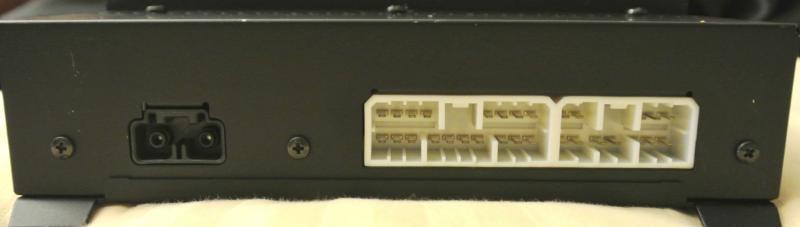

Thanks for the info Nardoswiss. Do you know if the C2S38103 is the same as the C2C25736?
Ive tried to look for images of the amps but haven't been able to find any of the connections themselves.
Here is the connections for the 2002 factory amp. If anyone knowns if this is the same connections on either C2S38103 or C2C25736 I would appreciate it.

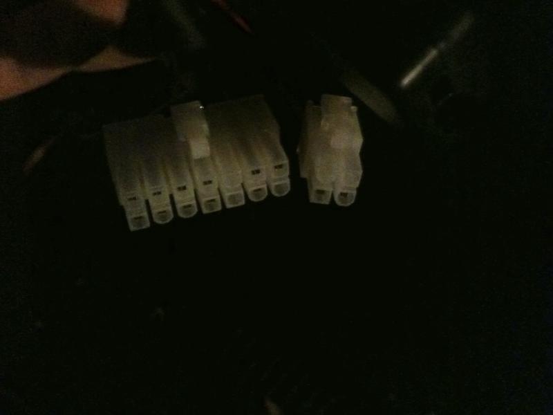

Ok so i was able to find a photo of the C2C25736 and it has different connections than my 02 amp.

Thanks Nardoswiss. I got the C2C25736 from another post here on the forum
https://www.jaguarforums.com/forum/x...ade-pics-4556/
I was hoping that since my car already had the premium audio and just an older amp it would be a simple switch but I guess im going to have to do some type of modification for the harness.
